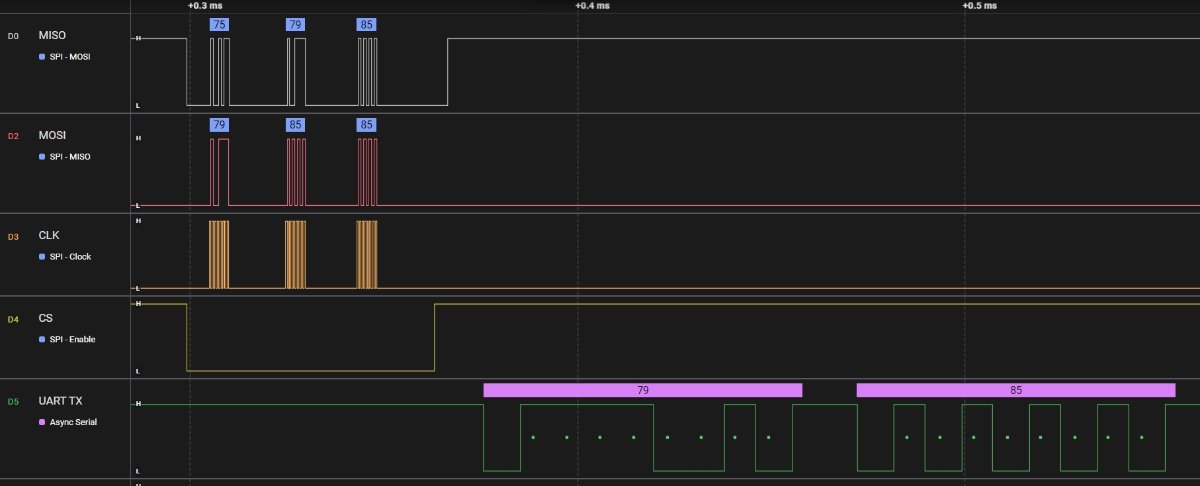

What I am trying to do for Testing is ,
1: Master sends char 79
2: Slave receives 1 Char 79 --> send it back master (79) and then also send char 75
3: Master receive 2 Chars and send them out via rs232
But there is something odd the slave is not transmitting the data in the right sequence
and Master should be receiving 79 and 75 not 79 and 85

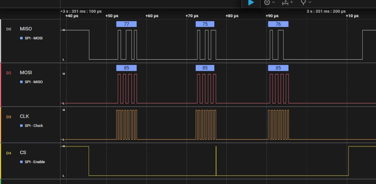

Hi, making some progress here
but I still have a problem with the sequence in which the data is transmitted
from the Slave, I am sending 75, 76 , and 77 but on the Locig analyzer I see 77, 75 , 76
any idea how can I fix this please?

Post by mnfisher »
I managed to get the slave to return data reliably - but only for one character at a time. If I attempt to do 2 bytes - the second value returned is the first value received.
I've tried setting SPDR in main and in the interrupt handler.
You are attempting to send 3 characters in the interrupt handler - which won't quite work (you are waiting for the interrupt to be 'set' again without clearing the flag) (it is also not a good idea to 'block' in an interrupt handler) - SPDR needs to be 'loaded' with a value to send before the master clocks data out to the slave (the slave cannot initiate the data transfer) - as the slave receives a data byte (and clock) from the master it replies with the data held in SPDR.
The sample here returns A..Z (as the first byte) and 'Z' as the second - which is the first byte sent by the master. All the samples I've found just show a single byte transfer (turn on a switch type).

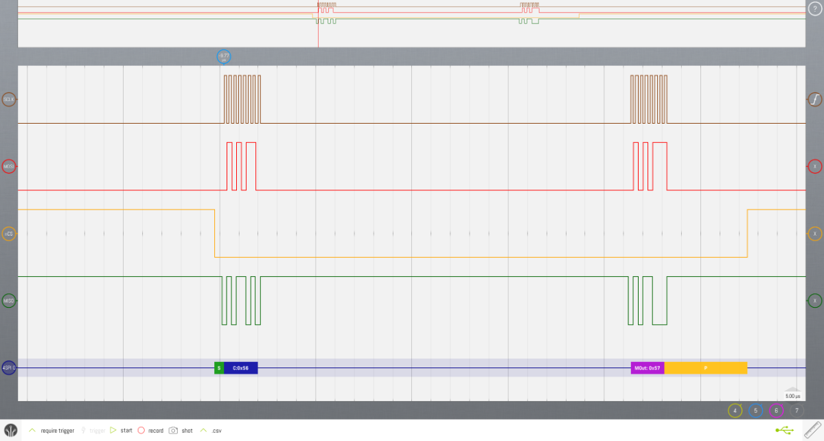

A little experimenting and a 20uS delay works well...
Here decoding the values returned by the slave...

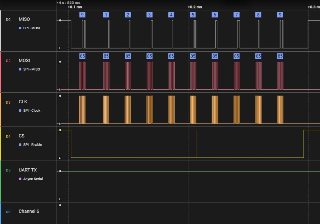

HI Mnfisher,
I just realized that this is not a problem at all cos only the last byte is always put at the beginning
so we can even use this to our advantage example the last byte you send is the number of bytes to be received
by the Master since the master is going to receive it first thing we can use it as a loop count to receive the
rest of the data .
For example, here I am sending 1,2,3,4,5,6,7,8,9,9

Re: SPI Master STM32f411
Post by mnfisher »
Looks to be working well!
The code is nice and simple too :-)
