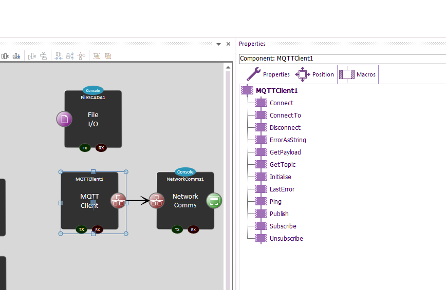

I add the mqtt in my Pc App project but I can't see MQTT::Read function in the MQTT Component of Pc App.
If I understand good, I need of this function to check message update.
Capture d’écran 2025-05-05 002229.png (61.31 KiB) Viewed 6354 times
If I check the MQTT Component of the Wiki, I have not MQTT::Read function.
How to follow the MQTT Comms Pc App Example ?
EDIT: I just find this function in "Private".

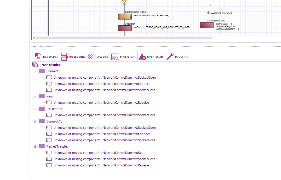

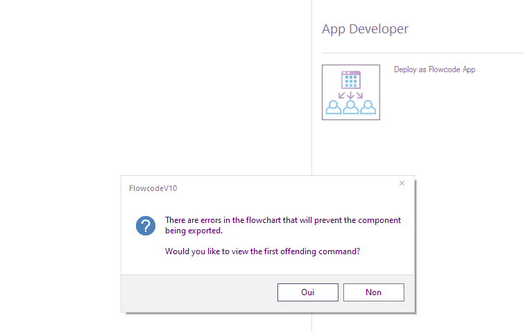

I downloaded the source file of MQTT Component from Wiki to open the MQTT::Read function but I have an error when I want export the MQTT Component about Network Component functions.
Capture d’écran 2025-05-05 135001.png (21.09 KiB) Viewed 6257 times
Capture d’écran 2025-05-05 135049.png (75.04 KiB) Viewed 6255 times
EDIT: I find "GetPayload" but don't work, I investigate ...
Connect is OK, Subscribe "topic" is OK, GetPayload without data in "result" and "val" var.

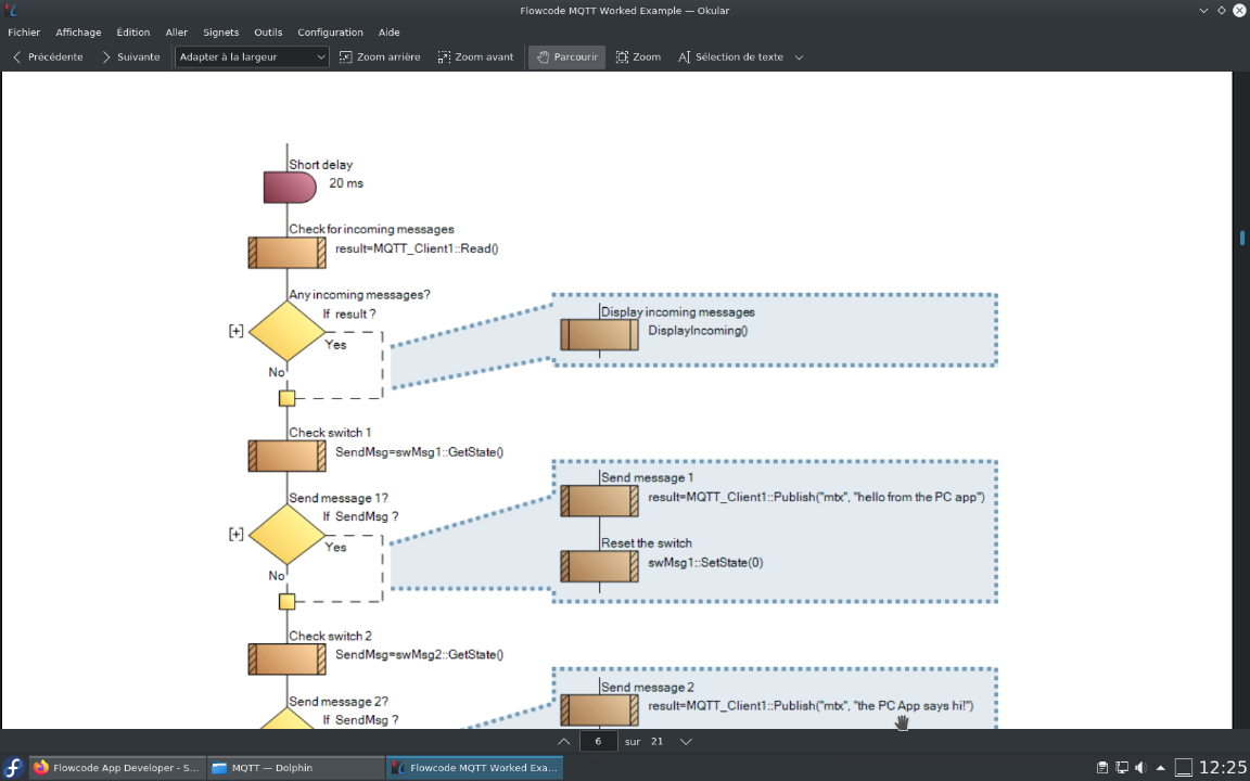

I opened the SCADA_MQTT.fcx file, we must also use MQTT::Read before GetTopic and GetPayload.

Posts: 2032
Has thanked: 306 times
Been thanked: 471 times
Re: Embedded device controlled from the Web without ESP
The latest version of the MQTT component should have the "Read" macro. Please download it from "Library Updates". It will be listed as revision number "9".
You can use "Library Updates" to download just the files you want. Open the screen and make sure only the components or files you require are ticked before pressing the "download" button.
