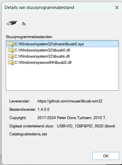

The programmer is shown as "libusb-win32" device with the same strange symbol (Pic-03)
I can't find any "matrix" details here. (Pic-04)

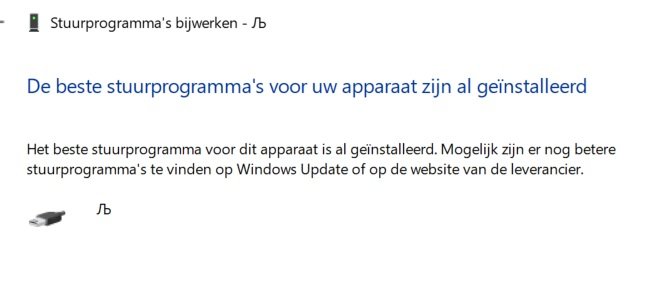

When I try to update the driver, it shows "best driver is already installed". (Pic-05)
I'm sorry it's all in Dutch.
I think maybe it is a windows setting or issue.
I can't seem to get it fixed for now.

Could it be that you have the v7/8 driver installed, but you need the v9 one? If so, try uninstalling the driver and downloading the one for v9.

Hello Steve,
The programmers that I want to use are the V6, V7 and V9 versions.
The V9 version works well, however, the V6 version has the driver problem.
I have not testeg the V7 version programmer yet with this driver.
Rinie

Those boards are very old and I don't think I have access to any, so I can't test.
You might get some luck from searching our old forums. For example, I found these:
https://www.flowcode.co.uk/mmforums/vie ... er#p107881
https://www.flowcode.co.uk/mmforums/vie ... ver#p71179
- Posts: 2061
- Has thanked: 311 times
- Been thanked: 479 times
Re: EB-006 drivers
And I remember seeing that odd symbol when using those old drivers, but IIRC it did not prevent the drivers from working properly.
