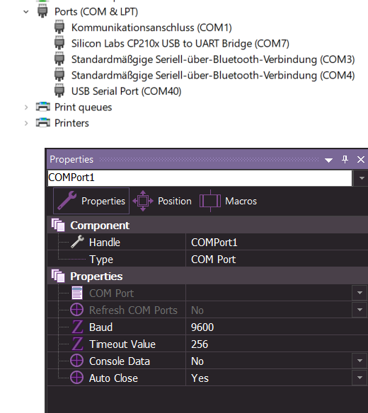

Hi Oscar, Hi Ben, Hi Steve
I like to use this auto comport too. But when I use the program from Ben, it don't shows me a port, even I have some.
What do I wrong?

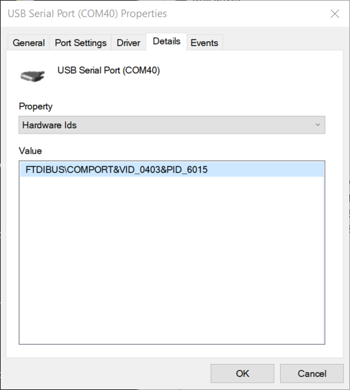

Which com port are you trying to open? the number 40?
Have you modified the VID/PID?

Is a FTDI Device?
I have tried several units (always with the same vid / pid) and they are recognized and numbered correctly.
I also tried to run the program on different computers and for now all fine.
Have you installed the official ftdi drivers? Have you installed the new dll?

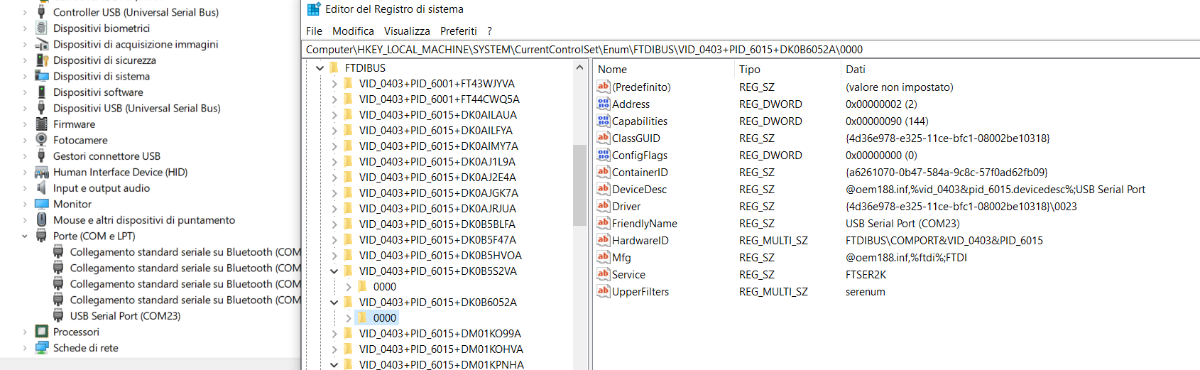

And if you go to the windows registry you find the same thing?
