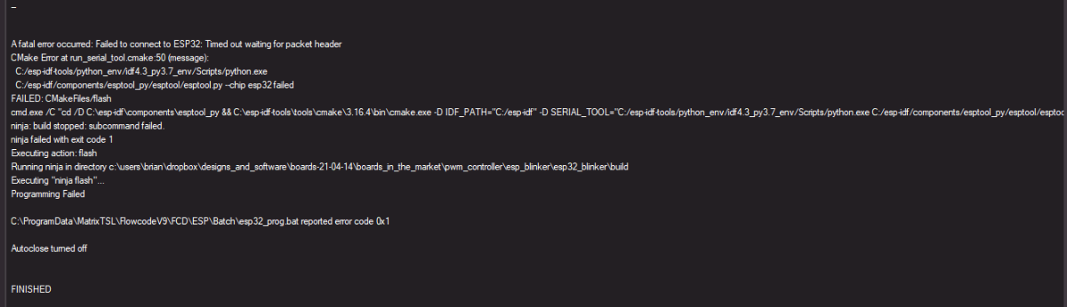

I think i found the problem the esp-idf-tools folder it was loading into the esp-idf-tools\.espressif when i changed that and took out the \.espressif it now works.
As I'm very new to this esp32 I have now compiled a simple blinker app to try get every thing going but it fails i'm not sure if it could be the board rate which is set at 115200 i'm not sure where i can change this to check
- Posts: 2494
- Has thanked: 800 times
- Been thanked: 866 times
Re: ESP32 Compiling error
Hi, Brian.
That looks like a communication issue between your PC and ESP32board.
Have you checked within the device manager to see if your board can be seen within the Ports (COM & LPT) section?
With some boards I have, there was a need to press the reset button on the board before it would program.
Have you selected the ESP32 Programmer Port within project options?
jollybv
- Posts: 152
- Joined: Mon Mar 08, 2021 11:25 am
- Location: Cape Town South Africa
- Has thanked: 42 times
- Been thanked: 15 times
Hi, guys
Thanks for all the help I now have a blinking board so we up and running, the reason that it was not communicating is that i had a bridge on the development board pulling RX down just one question do i need to put the C code with OSCCON=0x50; in the beginning of my esp32 projects? and another thing do I set the clock speed in project options to 240Mhz or 40Mhz

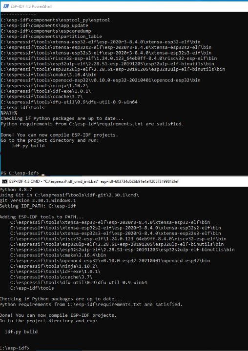

On a second computer I have again this Python is not installed problem even the test give a OK.
In this computer it does not help to run the install.bat again
C:\ProgramData\MatrixTSL\FlowcodeV9\FCD\ESP\Batch\esp32_build.bat "C:\esp-idf\" "test_install" "C:\FC9_esp32\4install\" esp32s_sdkconfig

Building test_install ...
Error: The following tools are not installed in your environment.
python
Please use the Windows Tool installer for setting up your environment.
Download link: https://dl.espressif.com/dl/esp-idf/
For more details please visit our website: https://docs.espressif.com/projects/esp ... setup.html
'idf.py' is not recognized as an internal or external command,
operable program or batch file.
Build Failed
Autoclose turned off
FINISHED

LeighM
- Posts: 558
- Joined: Mon Dec 07, 2020 1:00 pm
- Has thanked: 111 times
- Been thanked: 302 times
Could you run the ESP-IDF command prompt, then type
export
