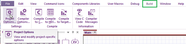

That is Project Option window.
But I do not find Build Option.
Please teach me slowly.

When you what to change the target of your project, you use the Build ribbon then Project options as can be seen in the image below:
Build ribbon.png (51.71 KiB) Viewed 9820 times

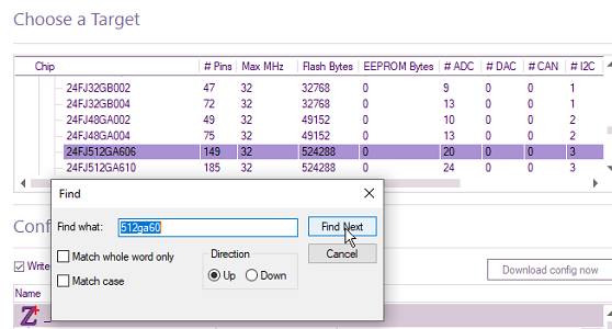

A tip for changing target.
Right-click on any random target, then select search.
Enter the partial name of the new target in the find window, in your case
512ga606
Find target.png (69.56 KiB) Viewed 9820 times
Click on Find next.
When you change your target, you much make sure all configuration settings within the Project Options match your hardware.
Then check all pin connections for every component and inputs/outputs are also correct.
There are great tutorials if you want to learn more about how to use Flowcode
If you select Education at the top of the page, there is a full course.
If you don't have the E-blocks 2 hardware, then just rely on the simulator.
Alternatively, Just for getting you started you can use one of the getting starting guides by selecting the Support, Support Home menu at the top of the page.

The core of the question is, if you select PIC24FJ512GA606 and run compilation or download, the existing selection will be changed to PIC24FJ512GB610.
seokgi
Posts: 246
Joined: Thu Dec 03, 2020 1:43 pm
Has thanked: 8 times
Been thanked: 9 times
Re: PIC24FJ512GA606 download error!
Post by seokgi »
As your advice, if you select and compile, the target device is changed. It is possible to check without MCU.
