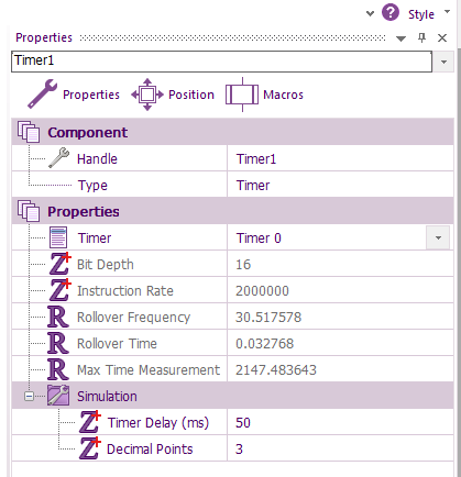

Next hurdle. For some reason, the timer returns zero elapsed time, even with a deliberately inserted 4ms delay.
Looking at the timer properties there is a 2MHz coount rate specified with no option to change it.
Does FC, knowing the osc freq, insert a prescaler to get to 2MHz?
My processor runs at 32MHz.
Could that give a conflict?
Jan Didden

It's a mistake to try and do so much in the interrupt handler - the LCD handling needs to be moved into the main code.
The interrupt handler needs to be as quick as possible (and not rely on any code that uses interrupts for timing (SPI/i2c/UART etc) or to have a delay...
MArtin
MArtin

Thinking about it on the way in to work - it might be easier to reset the timer after recording each pulse (removes the need to save last time and do current - last)
It's a pity that the get_time routines (except raw?) use floating point maths - which means the interrupt handler is a little bit slower (the golden rule is keep it fast here)
It should be fairly easy to combine this with the state machine from before and read the IR code entirely in the interrupt handler (and set a 'flag' on received)

Martin, I understand the need to keep the ISR short and fast, but I was just trying to read the timer, not to get any accuracy.
And yes, I intend to reset the timer after each detected pulse.
So far it just returns zero when I read it. If I solve that I can move on.
Appreciate your input.
Jan

The interrupt handler has print statements and a 250ms delay - this is very unlikely to give the results you want / work at all...
