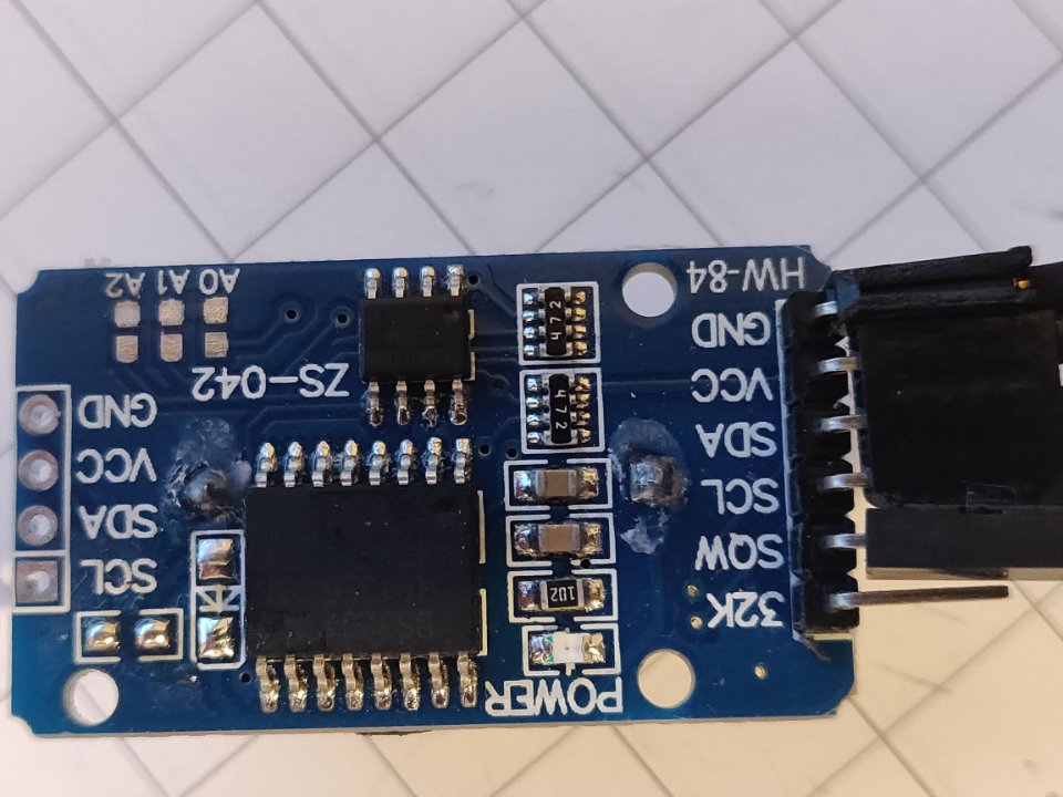

I tried your program but the led does not show signs of life, the only things I changed are the LED port because on my nano there is already an LED on B5 and I feed the DS with the 3.3V coming out of the board, if I disconnect pin interrupt 1 (D3) the LED flashes very quickly so as long as everything is correct, I tried with 2 DS3231 cards with the same result

All looks okay (and the inbuilt LED on B5 (pin d13) - should light as well. Assuming you have a current limiting resistor in place - the LED shouldn't 'flash rapidly' if you disconnect the interrupt pin (it should just 'light' and then turn-off on the next interrupt (although a 'floating' pin might generate random interrupts?) The code just lights the LED with a 1 minute on and then 1 minute off cycle (after a delay of up to 60s - depending on start time).
It is possible for the ds3231 to be in a 'crashed' or 'inactive' state (your previous code - an interrupt could occur during a attempt to read the time - which might cause i2c errors (due to the 200ms pause) and result in this state)
If the rtc is in this error state - then if you read the time it will display as 11:11:11 (if I remember rightly) - try reading the time and outputting it to the UART... You'll need to use a terminal program (I use 'putty' from https://www.putty.org/)
It can be 'reset' by setting the time (or try RestartRTC and then set time).
Another bug - if you enable the SQW then this value is 'sticky' - with no way to disable it. Initialise probably needs to clear this.
