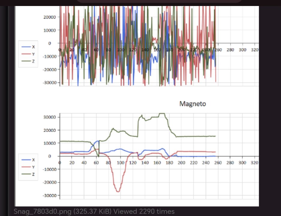

Perfect! it's working nice!
The data is from the Accelerometer und Gyro is now ok,
and the program can now dedect, if one or both sensor are connected and save one or both sensor data in a CSV File.
I will still try to read and write the registers but that will take a little more time.

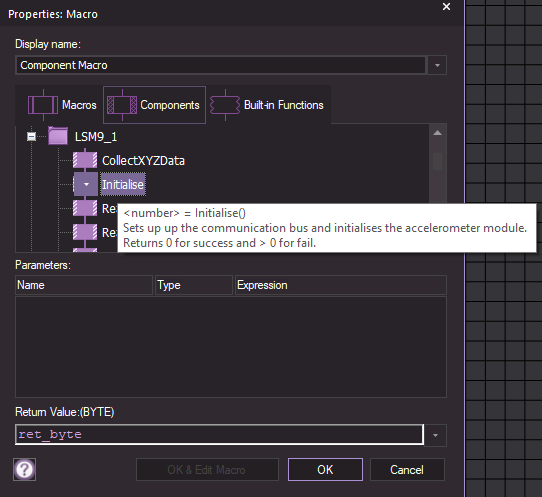

I think, the text is not correct anymore. The text should now be like this:
return >0 for success and 0 if the device is not responding correctly

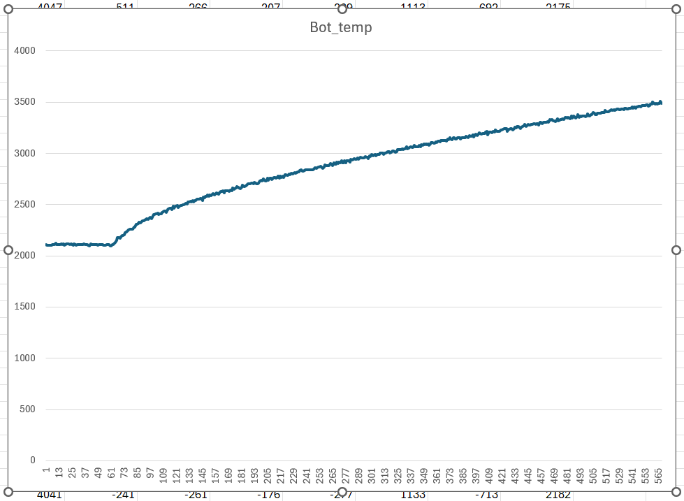

The temperature is displayed from -20000 to -5000 but I suspect this has something to do with the the output of the sensor is 0 (typ) at 25 degrees Celsius. Do you have any idea how this works? maybe I can simply convert this, but what exactly does LSB/C mean?

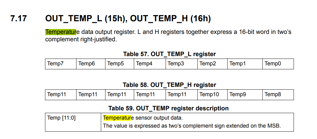

It's worse than I expected. It's a 11Bit value but out_temp_H register have 5 times Temp11.
is there a way to read the temperature? how can you convert it into degrees Celsius?

I'm just going off the datasheet as I'm not familiar with the component or device, so this might be wrong.
LSB/C is the measure of temperature sensitivity. It is 16 least significant bits per degrees C. So 1 degree change with alter the value by 16 bits.
I don't think the 5 values for Temp11 make any problems. Here's the maths:
[edit: I've corrected the offset value from 20 to 25]
- Maximum value of the registers will be 0x7FF = 2047. Divide this by 16 = 127.9. Add to 25 gives 152.9°C.
- Minimum value of the registers will be 0xF800 = -2048. Divide by 16 = -128. Add to 25 gives -103°C.
- A register value of 0x0000 is 0. Divide by 16 = 0. Add to 25 gives 25°C.

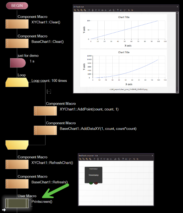

The data is from an ESP32 send by bluetooth or USB, received as array, in the AppDeveloper. So the chart are from the AppDeveloper.
I have a demo for the chart and a practical addition for the charts.
With printscreen (macro) you can automatically save the chart (results) as .png files.
Start the app with F5.
If you want, switch on the printscreen macro and then view the .png file on your computer C:\All_export\.

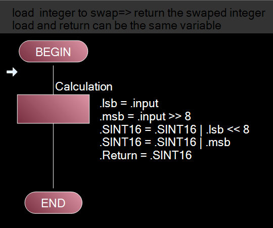

Yes you are right, you have divid by 16 and add the temperatur value of 0x0000, for this IC it is 25 degrees.
I saved the temperature values in an Excel file. (Not calculated value)
However, the values were much higher as you wrote. So I used the DEZINHEX() function in Excel. Result was suspected that Hbyte and Lbyte are swaped.
Excel: So I also swap the Value from the temperatur and made a calculation.
For me it's practical if I use all values as signed integer.
For the temperature I calculate x100 and I have to divide it by 100 again later in excel, but in excel I have decimal numbers with decimal places. For me, the only wish would be to swap Hbyte and Lbyte in the component for the temperature.
or you can leave it as it is
Excel with temperatur x 100, for the test heat up the LSM9DS1 swap is a macro from me:

Re: ESP32 and LSM9DS1 not compiling
stefan.erni wrote: ↑Thu Jun 06, 2024 1:59 pmYes you are right, you have divid by 16 and add the temperatur value of 0x0000, for this IC it is 25 degrees.
Thanks, Stefan. I have corrected my post to use the offset 25.
And I will ask for the component to be fixed so that the return bytes are the correct way around.
