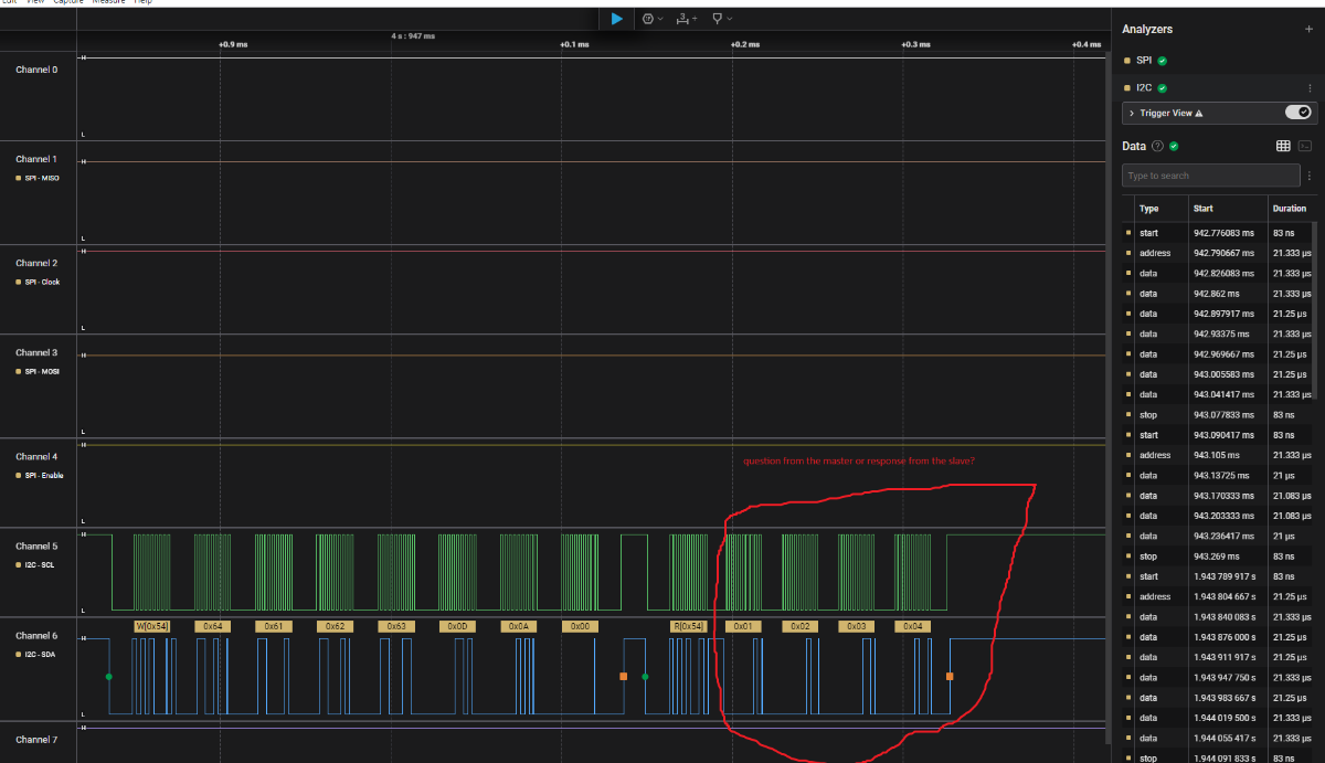

Hi Martin, I was playing with the master software and I added the UART output but I don't read what I expected 1,2,3,4, I definitely did something wrong, but I wanted to ask you on the oscilloscope I see the transmission of writing A, B,C,D and then the reading request, the question is: is what I see on the screen just the request or is it also the slave's response? to answer your question the slave will be connected via SPI to a TOF sensor for reading the water flow (and this works) and collects the data, will carry out calculations to obtain the flow speed, and will send them 1 time per second per master who will take care of displaying them on a screen, then will have to control the 4..20ma, rs485, impulsive outputs, furthermore from the keyboard connected to the master the programming data will be sent to the slave which will send them to the sensor, at this point perhaps it was Is it better to do everything in SPI starting from the master that controls both the slave and the sensor?

What you see on screen are the slaves reply - the master just requests the bytes (Read request (bit 0 of address is set) - sending 'ACK' after each is received - until it sets NACK on the final byte)
The reason they aren't displayed (on UART) is because the slave is returning 1, 2, 3, 4 (NOT '1', '2', '3' and '4') - so you can either modify the 'reply' array in the slave code or add '0' to each value in the master to convert the values to ASCII. Alternatively use a loop and SendNumber().
