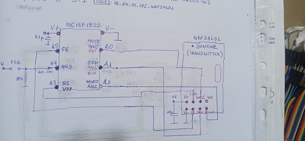

The problem is that I need an extra pin for Analog input for transmitter and a DAC OUT for receiver ..so, I'll try to retain PIC12F1822 at transmitter changing the connections as follows
Transmitter
PIC12F1822 NRF24LO1
A.0 MOSI
A.2 MISO
A.1 SCK
A.3 CS/SS
A.5 CE
A.4 Analog IN
Save and debug OK, so I can program the chip.

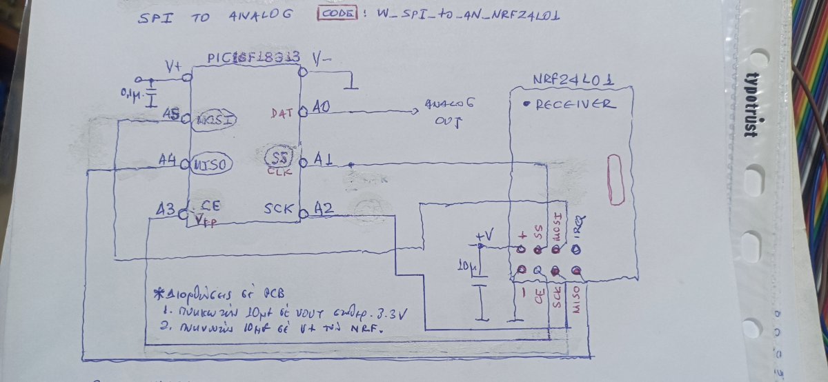

About receiver , I can't use above chip, but I have a PIC16F18313. I'll try to find if it's possible to make the connections , cause I need an extra pin
for DAC OUT.

I think you might have issues with the above connections as although you can set MCLR as internal (A.3), the pin then becomes a digital input.
However you may get away with not using the CS/SS pin at the MCU at all. This pin is necessary when you have multiple devices connected via SPI to let a particular device know that the comms are meant for it. As you only have one device, the transceiver, all comms will be for it so you could just hold that pin low on the transceiver itself.
Hope this helps.
Hope this helps.

I hope that is the last update ..I use SS in both pair. Something for that I'm confused ,is connection MOSI, MISO between PIC and NRF...The correct is MISO-----MISO /
MOSI------MOSI or MOSI------MISO / MISO------MOSI ?
I've seen both connections ways in many examples.
Basil
Basil
- IMG_20240909_000425.jpg (123.67 KiB) Viewed 214499 times
- IMG_20240909_000704.jpg (125.59 KiB) Viewed 214499 times

In the schematic for your 1822 you have A3 as SS. When you set the chip to use internal MCLR the pin can then be an input but not an output. If you leave it disconnected or perhaps tie it and the SS on chip to 0v then it should work OK.
Same with the 18313, the pin A3 can only be an input. Again as you are just communicating with the transceiver you could perhaps swap CE on pin A3 with SS on pin A1, and then tie SS on A3 to Ov.
Sorry, can't help with the Pickit as I use the Multiprogrammer from Matrix.

You've right about A.3, I didn't noticed that...Tomorrow I'll make corrections and test the code for receiver/transmitter.
About programmer for PIC, I was found solution , so I'm ready for programming.
Many thanks.
Basil
Many thanks.
Basil
