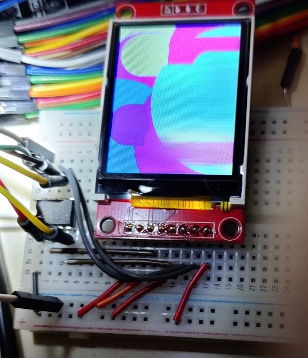

Post by mnfisher »
With PICKIT 3 providing the power..

Post by mnfisher »
You'll need to set the clock speed etc in program options... Whatever it runs at (19MHz??) - it will affect the delays
Looking at the CAL_SPI TransactionWriter code - it just call Master_byte multiple times - so I can't see why the transaction version doesn't work - but tried it again and it doesn't :-(
Sorted - It wasn't working with transactions because the buffer in Initialise was too small (I'd initially left out the gamma adjustments which needed 16 bytes...)
Phew

NP
for info, Ive added a thermistor into my circuit and an extra line to display the temperature and now the screen takes 12 seconds to update the data versus the previous 6 seconds - still using the ili9163 component. Is this problem more pic related?

Post by mnfisher »
Seems - very slow... Can you run a 1s flasher correctly?
I've got a LPLC PIc18 board from a Kickstarter (back in 2014!) - and can't find any docs on it (pinouts etc) - so it is going to take a bit of play to get it working.. So far - I can program it :-) and have a 1Hz flasher running -but seems to be using a 4MHz clock (should be 48MHz) - so I've a way to go yet...

Post by WingNut »
So I stuck a led in and a 5 second flash in 3 different locations -1 at the very start of the program, one immediately after initialising the display and one in the main loop to see if I could tell where the issue lay.
At 40mhz the led is on full time so i changed to 1mhz and the first stage flashes at 1 second (5 times). The next stage takes a few seconds to start flashing so the initialisation is slow. It then flashes for 1 second (5 times). The next stage in the main loop flashes 5 times at 1 second but the display update remains the same (plus the delays)
