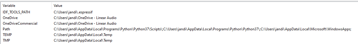

These are the environment vars in the working system.
westende environment vars.PNG (14.47 KiB) Viewed 16616 times
Jan
