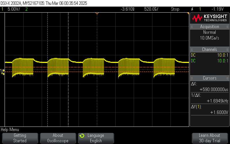

Just tested and it does work in an interrupt... I tried 1ms. I needed a longer delay than n = 8 for reliable read - at least on my logic analyser...
Looking at the trace and I think the delay could be a little smarter (so maybe passed to gpio_set as a parameter) - as in some places there are very short pulses (increase delay a bit) - whereas other cases where there are other function calls are longer (reduce delay).

Hi Martin
Yes, that works. For a 1Mhz clock I don't need a wait.
I have not yet tested the values I am reading, but it is fast and in the interrupt macro! That is very good!
no delay ist the best:
with while: no wait 1Mhz:
