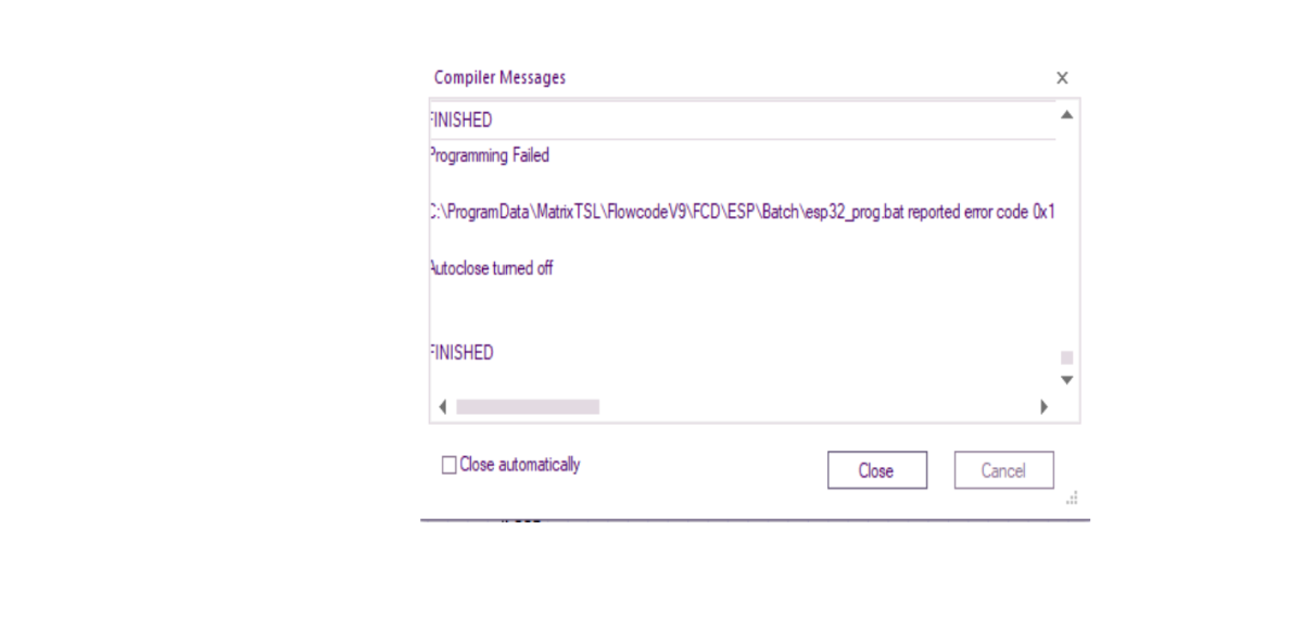

Yes, I have chosen the COM4 Port in the settings.
Yes, I have pressed the 2 Buttons in all possible sequences and combinations before sending the program to the device.
Unfortunately I still got the message : Programmng failed
Here is my msg.txt file

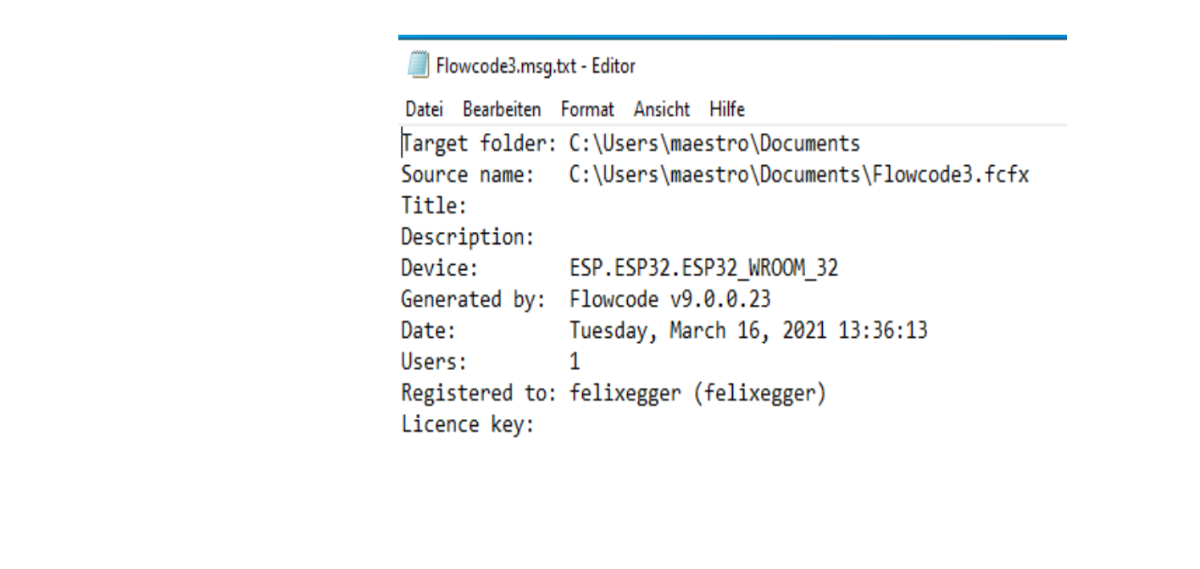

Could you please attach the actual Flowcode3.msg.txt file?
felixegger
Posts: 48
Joined: Wed Feb 24, 2021 1:20 pm
Been thanked: 2 times
Re: ESP 32 Toolchain problem
Post by felixegger »
Compiler message
LeighM
Posts: 558
Has thanked: 106 times
Been thanked: 302 times
Post by LeighM »
The images do not give us enough information, please attach the Flowcode3.msg.txt file ...

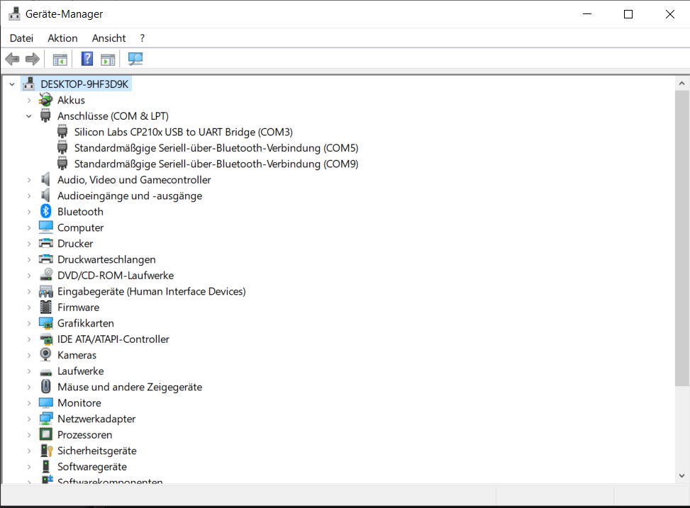

Hello Felix
first I would suggest to just compile your programm just as a HEX file.
If this compiles OK the main part of the toolchain seems to be OK. If not different story.
Secod step compile and prog/flas your ESP32 device.
With my ESP32 WROOM device wich I bought from AZ Delivery there is no need to push any button in order to prog/flash.
It will be progged always direct from the FC9 surface.
In case that progging is a problem check your device manager that the ESP32 is available under COM ports.
Pls. see the following example:
In my WIN10 case it is installed under COM3 as Silicon Labs
BR
Dirk
Happy FC9, FC-8 and FC-6 professional user ;)
