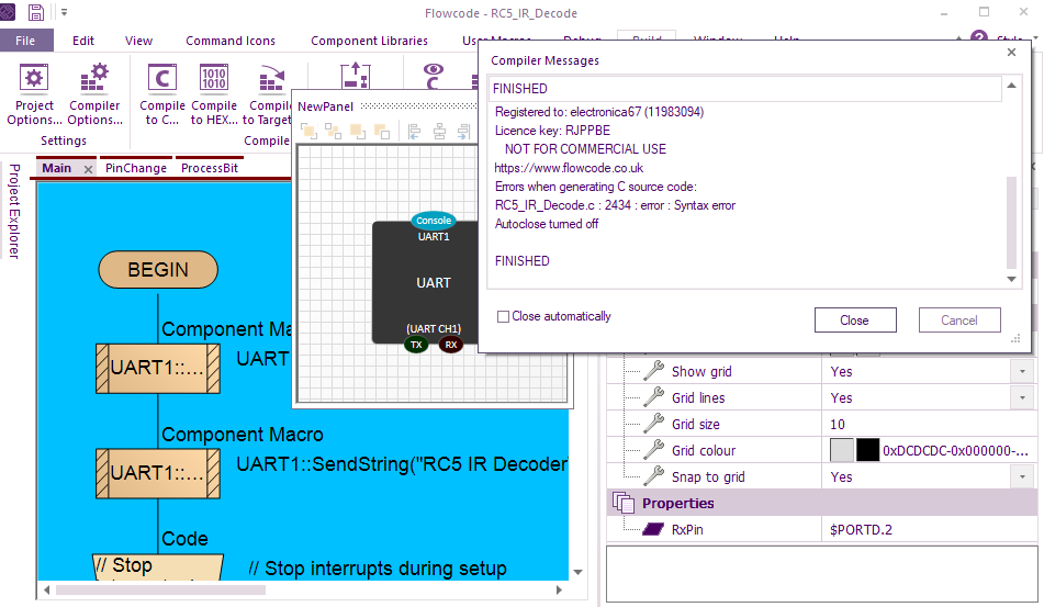

I started by testing the Arduino receiver, but I only have the Arduino set up in Flowcode 10; do you think that’s why I’m getting this error when programming it
And you created the flowchart in Flowcode 11.
Enrique
Enrique
- DEC_ARD.png (89.08 KiB) Viewed 5041 times

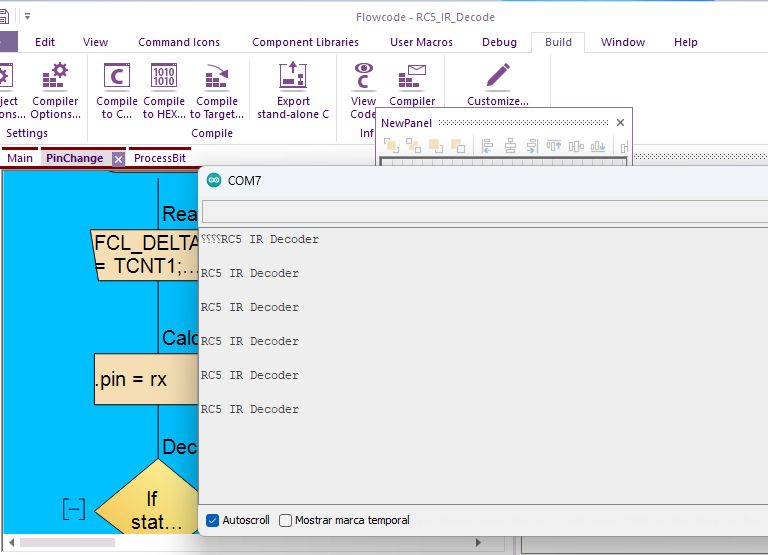

I’ve been testing the Arduino flowchart, but I haven't managed to get it to detect numbers. I used four IR remote controls, though I’m not actually sure if they operate on the same frequency as the receiver; among them is the Xinda remote sold with the Arduino receiver, which, as far as I understand, uses the NEC protocol.
Enrique
Enrique
- Captura de pantalla 2026-08-26 214735.png (64.33 KiB) Viewed 5030 times

Did you try using the 12f transmitter?
The rc5 protocol seems much less common than NEC format (all the controllers I've tested generate NEC - somewhere i have a one-for-all stick that can do it, just haven't managed to find it)
The good news maybe is that i did a NEC decoder with Jan a few years ago.
