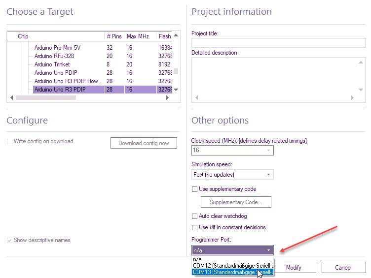

After selecting the correct hardware e.g Arduino Uno (You don't want to select Atmega chip), it sounds you have either not selected the Ardunio compatible port within Build ribbon, Project options, .
At the bottom right you should see Programmer Port:
It should not show n/a.
Make sure you can select the hardware comport.
If you can't then you might not have the correct driver installed?
Can you check with your device manager and see if there is a new port within the Ports section with the Seeduino plugged in or a yellow ! somewhere.
Then they disappear with your Seeduino unplugged?
If you have not already installed the driver, you will ever require CH340 or CP210x depending on what version board you have.
See here
