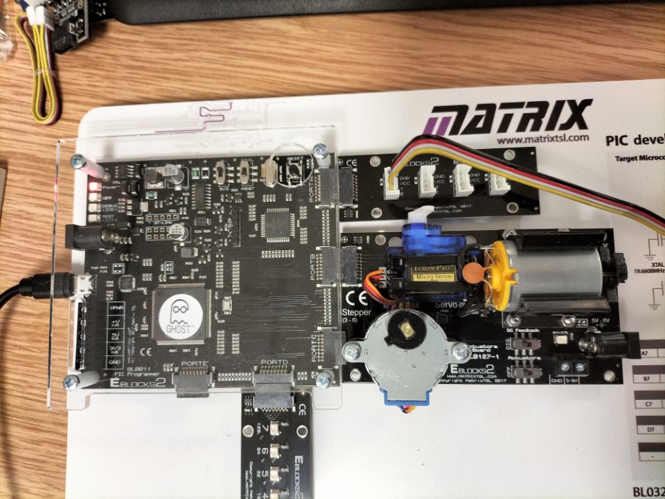

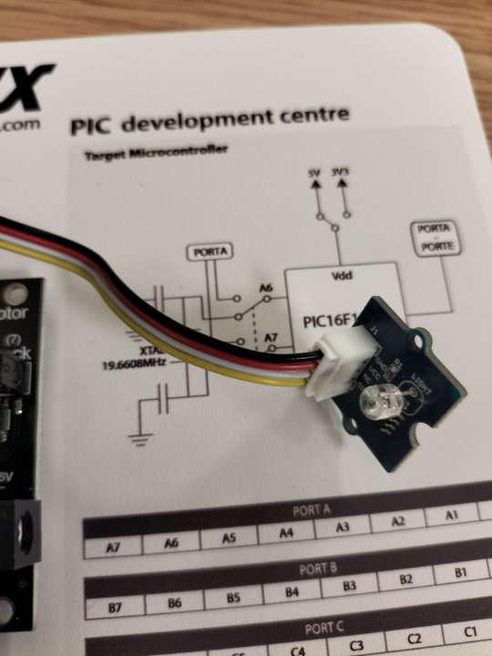

Thanks for your help, Whilst the simulation operates ok I have the same issue in that the output D0 is always on regardless of light condition. I have the following set up. EBLOCKS 2 Grove board BL0129-1 connected to a grove light sensor. I have set the channel input to An0 as the grove board is connected to port 1. Can you please help I have attached a file and a photo of the set up

What I would recommend is testing that the sensor is working as expected.
If you load the attached flowchart onto your hardware you expose and shade the light going to the sensor and observe the value via the LEDs.
Each LED from 0 to 7 increases by the power of 2 ,i.e doubles in value.
Therefore LED 0 = 1, LED1 = 2, LED2 = 4, LED3 = 8, LED4 = 16 ........LED7 = 128
First partly shade the sensor so it's at the level at which you want the threshold of the LED to light
You will need to look at what LEDs are on and then add together all the values.
E.g LED1, LED3, LED5 & LED6 are the only ones on the the value =
If you want the LED to go on when the sensor is partly shaded, set the value for
If the LEDs don't change with brightness then there could be a hardware issue.
You can measure the voltage across the signal of the sensor and ground.
The signal voltage should be Supply voltage/256 * value derived from lit LEDs
Using 106 as the example and the supply voltage is 5V
Then the voltage across the signal pin (A0 id the micro) should be 5 / 256 * 106 = 2.07V
If I was you and the LEDs 0 to 7 do change value with brightness, it will be worth noting the full light and fall dark values.
