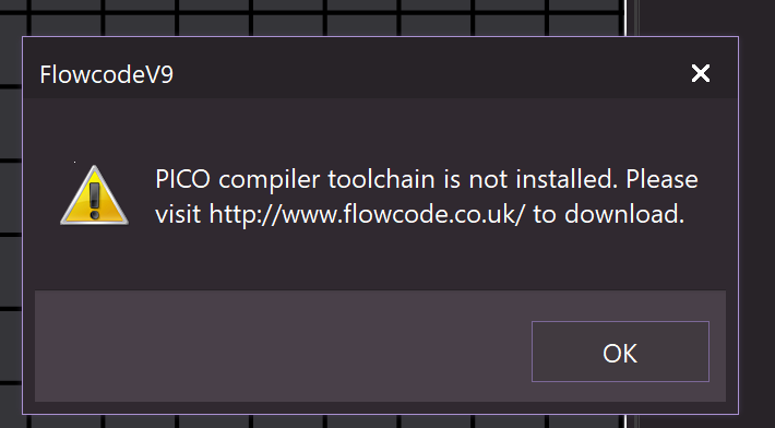

PICO toolchain NOT working - latest version installed from FC9 version
Screenshot 2022-08-05 at 10.26.48.png (89.81 KiB) Viewed 2051 times
Screenshot 2022-08-05 at 11.12.33.png (27.23 KiB) Viewed 2051 times

You should be able to point at the location of the PICO-SDK toolchain using the "locations" tab in Flowcode's "global options" screen.
