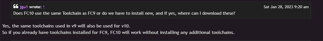

I ask here: viewtopic.php?f=13&t=1667 do I have to download toolchain again for using FC10

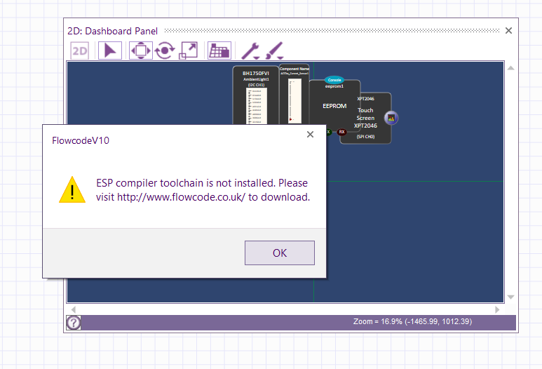

Martin reply, if I already have toolchain installed for FC9 FC10 will use these. I opened a project from FC9 and try to compile to ESP32 but get the message:
Please what to do?
Toolchain!

Hi Jorgen.
You won't need to download the toolchain again.
What you will need to do is follow page 8 of this guide.
It will state that even if the toolchain is installed, but step page 8 is missed out.

You are fast Martin
I already figure it out, I have to set the path for ESP. Or was I to fast, sorry
After copy from the path from FC9 to FC10, FC10 compile my program from FC9 exellent.
