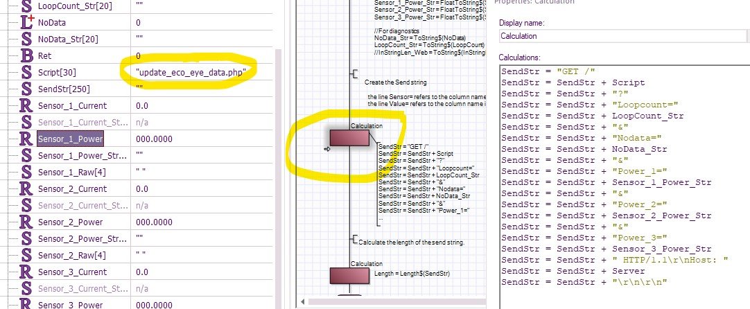

The first thing I did was edit the FC code to give the output I required.
FC edit.jpg (137.6 KiB) Viewed 24614 times
You need to add your data to the "calculation" but do not forget to change the "script" as well if you have renamed the PHP file.

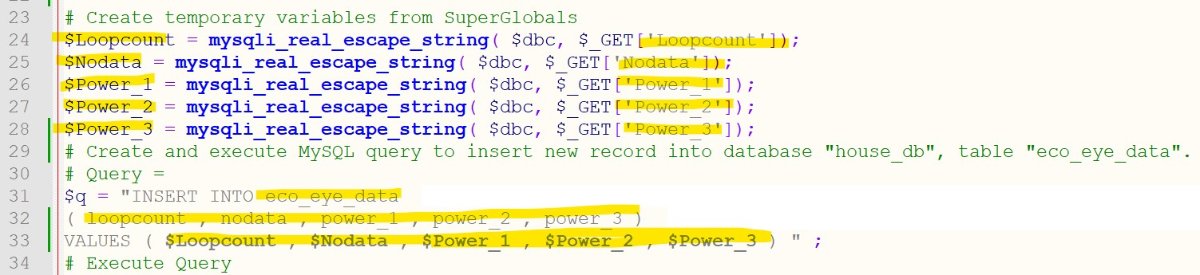

The GET variables need to match what you have called them in the FC send string, the names of the global variables can be anything but need to match what you put in the bottom line (VALUES). The database table and titles in the INSERT INTO need to match what you have called them in your database/table.

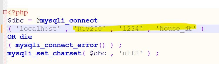

Do not forget to change the database name and login details (in connect.php) if you have changed them.

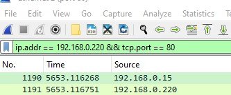

If it does not work straight away (which is why I thought of doing this update) I found Wireshark a good tool.
There is a whole load of data flying around your network so I set up a filter for just what I needed. I was also only sending every minute so without it I was inundated with irrelevant stuff.
wireshark filter.jpg (15.99 KiB) Viewed 24614 times
This is the IP address of the sending device and the port you connected to in FC.
This shows the data captured and the entry in the dB.

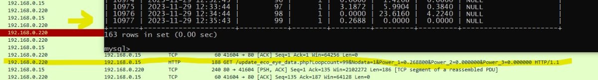

Just for completeness I have recreated an issue where wireshark showed the packet showing the string which was as sent but the database did not update at all.
Here is the wireshark image showing the sent string.
wireshark error.jpg (23.83 KiB) Viewed 24600 times
If you look after the packet you will notice (I did not originally) that there is a response/reply from the receiving PC with "400 Bad request".
I could not find out why this was happening so I removed it and it is back working as planned, it is for debugging so not required for the finished project.
In the earlier good packet I clipped it without the good reply, if the response is good you should see "200 OK" shortly after the sent data.

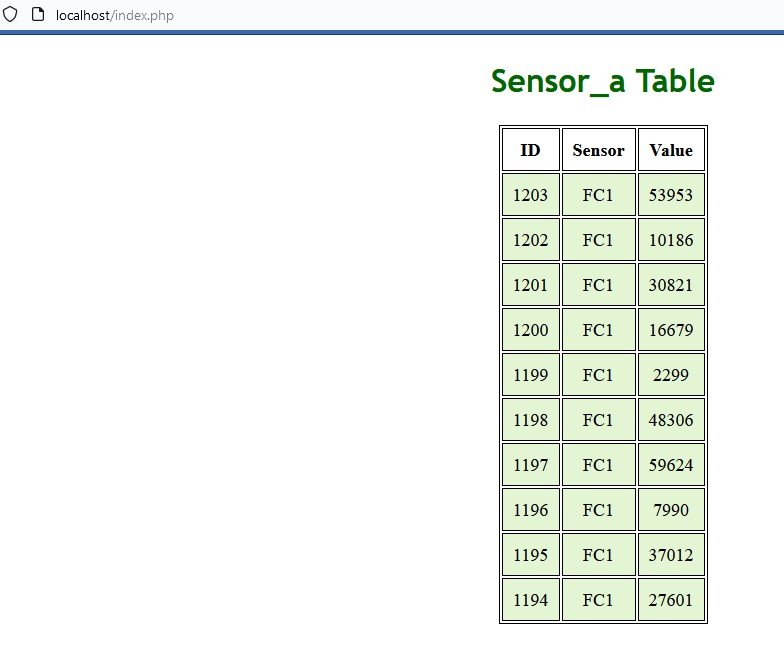

So following on from Chipfryers excellent example I needed to get the information out of the DB and onto a web page. I know it is not directly related to FC but I think it is relevant and hopefully it will save people hours and hours of trawling through books and the internet for what always seemed like over comlicated examples.
This example uses the my_db database that is created in the example above and shows the table on a web page, it also updates automatically without redrawing the page.
This is what it looks like.
