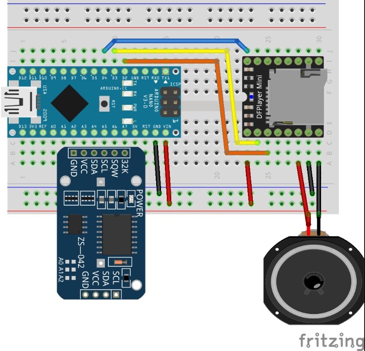

A little project using my dfplayer component (shortly available)
Some years ago BT (and Post Office before that) had TIM - the talking clock. You rang 123 (if memory serves) - and got "At the third stroke - the time sponsored by Accurist will be ..... pip pip piiiipppp" (note depending on your age - the announcer and message varied)
In fact you don't need a huge number of sound files.. I recorded 1..20, thirty, forty, fifty "At the third stroke the time...", "seconds", "second" and "precisely" etc These I added to a micro sd card as 001.mp3..020.mp3 etc.. Announcements are 100Announce.mp3 to make remembering which is which easier :-)
I also created some 'pips' which are 1000Hz sine wave (in two lengths)
One 'problem' is that the time needed is actually 'in the future' - as by the time the announcement is made the time is wrong (at the third stroke the time was ..... 15s ago....)
Another is that using the timer component seemed to mess up the software UART I used (this makes testing much simpler!) - so I use the ds3231 time to measure the delay between starting anouncement and pips (and add 15s to time...)
The board doesn't show it - but I added a button to 'request' the time. I powered it by putting +5v / Gnd to the bottom power rails - the Nano I used was faulty - just putting out 2v on the 5v pin - but it maybe possible to power everything from USB (although the dfplayer maybe pulls too much current when powering a speaker....)
There is scope for 'improvements' - for example playing a mp3 'alarm' in the morning. Or for making 'fun' announcements - I always thought a 'meal clock' would be good - "Its time for breakfast" - "30minutes after breakfast" etc
And - it works... Not sure a video is quite right (sound recording?)

I'd seen mention of the new UART component - although I haven't had a chance to try it - however I'd used v8 (I have commercial licence) in this instance, and used the CAL UART component. I wanted to create a component (for the dfplayer (soon on flowcodexchange.com (sorry - plug plug) )- and offer the choice of hardware or software channel. Probably would be better with the software version - 9600baud shouldn't be too much of a strain? I had the option of using the seconds from the RTC chip in this case too.
tim.fcfx
(22.08 KiB) Downloaded 1090 times
This comes in a <2k so the Nano is a bit over specified - it should work on most anything with a UART (hard or soft). I see the USI on ATTinies can do a workable UART - I might have a play with that.
Note that I used a button across D7 & D9 - I used the AVR built-in pull-up (to keep the wiring neat - in this case it's all that's needed - although it does require a couple of lines of C). Here I just use an input icon to read it - lazy - but I'm not sure on final 'trigger'.
Note that files are in a folder 3 (FOLDER) - because other bits in 01 and 02.
I'm thinking grandfather clock ticking and Westminster chimes. For a touch of class! (and using the 'advert' function it's easy to add the chimes over a 'tick' soundtrack)
Gosh - dial-a-disk - I'd forgotten about that - It's an mp3 player so Everlasting Love shouldn't be a problem (unless it's not on Youtube?) if it's that you crave.. The hardware looked a lot more interesting then.

Sure - which bit - 'tim.fcfx' is in one of the messages above.
The dfplayer component is at viewtopic.php?f=5&t=1605&p=9380&hilit=Dfplayer#p9380 - and I can post the source to this too if anyone is interested (note that FC has it's own DFPlayer component - I wanted one that supported 'adverts')
On the Nano (or AVR MCUs generally) I posted some code at https://flowcode.co.uk/forums/viewtopic ... 1307#p1307 that allows the use of the MCU's internal pullup resistors (which makes things like buttons a little easier to wire - I can't remember if I used that here, or if I used a resistor?)
