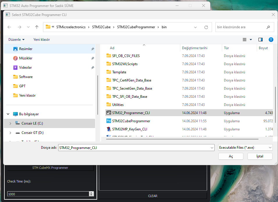

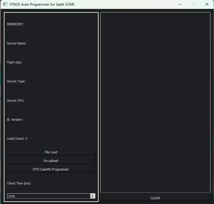

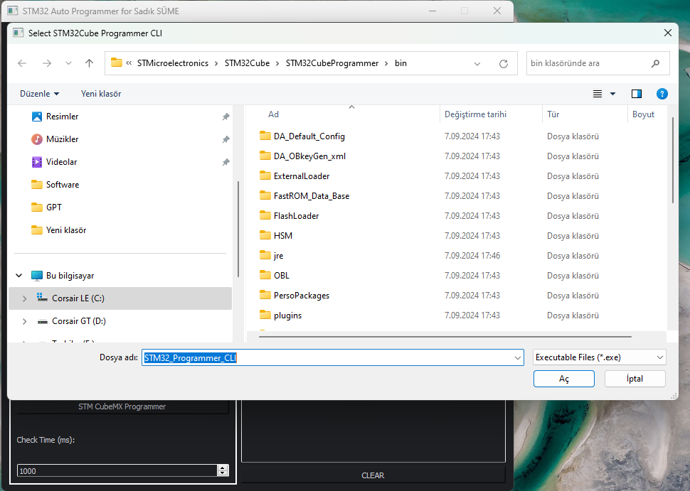

When the software opens, it will look like the "Program Init" screen. The first step is to locate the STMCubeMX CLI.exe file.
### Step 1:
Click the "STMCubeMX Pro" button.
By default, the STMCubeMX CLI can be found in the following directory:
`C:\Program Files\STMicroelectronics\STM32Cube\STM32CubeProgrammer\bin`.
None of the other buttons will be active until you select the STMCubeMX program.
After selecting the STMCubeMX CLI.exe file, confirm your choice.

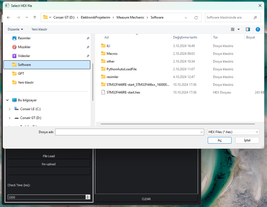

Select the folder where your software's HEX file is located (*.hex) and confirm.

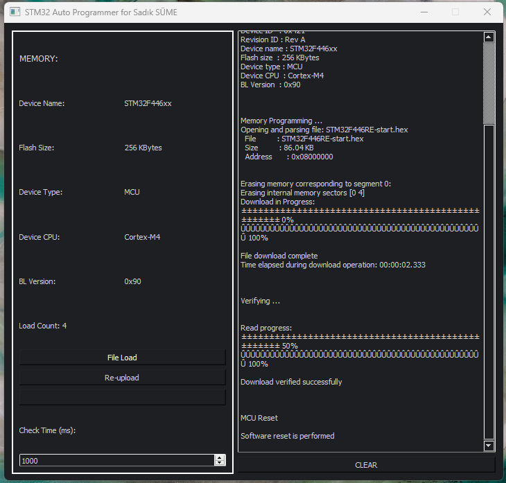

Once you make this selection, the program will upload your file once.
Afterward, every time you compile your program with Flowcode, this software will automatically upload it to your board.
Be careful when making the USB Programmer connections for +5V, SWDIO, and CLK.
Every time you press the "Reupload" button, the current software will be re-uploaded.

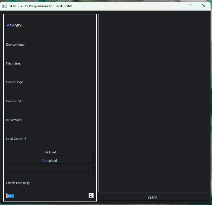

Check Time Settings
