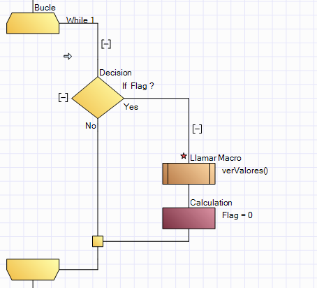

But since I don't have much knowledge about Flowcode and I'm learning, there are a couple of questions regarding the file you attached that I would like to know why they are used:
1º Within "timer_Interval", you have put a block "Required only for simulation".
Why is this so?
Additionally, within the main environment you placed a decision block checking the "Flag" status. What is its purpose?
Why is this so?

Re: Are interruptions not working for me?
1. There is a bug with the timer component simulation and the debug message is a temp fix to make it work.
As for the flag, I did make a mistake the verValores user macro requires dragging to the Yes branch of If Flag. It's purpose is to update the LCD printing to once every second when the Flag variable is changed to 1
