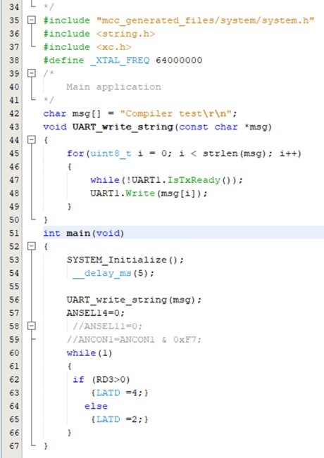

I created a test project in MPLAB X v6.25 to compare compilers. For XC8 v2.50 and XC8 v2.46 the ports and UART work perfectly.
I would like the components used in the Flowcode10 project to also be able to work within a project.
