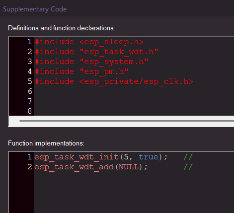

But I can not compile if,
I include
#include "esp_task_wdt.h"
and.
esp_task_wdt_init(5, true); // Timeout 5 Sec autoReset = true
esp_task_wdt_add(NULL); // NULL = aktual Task ( loop-Task)

I found the old way...
and I can include now but not yet reset the wdt in a c-code in the main loop
supplementery code
#include "rtc_wdt.h"
in main begin:
in main begin:
esp_task_wdt_init(5); // Timeout set
esp_task_wdt_add(NULL); //add Task
Yes it is different

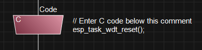

In the task (using NULL in task_wdt_add uses the current task) can you use
#include <esp_task_wdt.h> (in supplementary code)
esp_task_wdt_reset(); (in task)
Which would need to be called at 'intervals' of < wdt timeout.

Thanks for the help. I can now reset the WDT in the main.
In the main on start it's working just with this "Null". If I use "main" or "FCM_main" it' not compilling
to reset, it need a command more with vtaskDelay(1):
I can set the time to reset, using a timer, so I have every one second a reset wdt;
I reset the WDT in the main program.
reset in main: However, I still need to reset a wdt in a created task. Once in core0 and once in core1.
vTaskDelay(1);

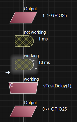

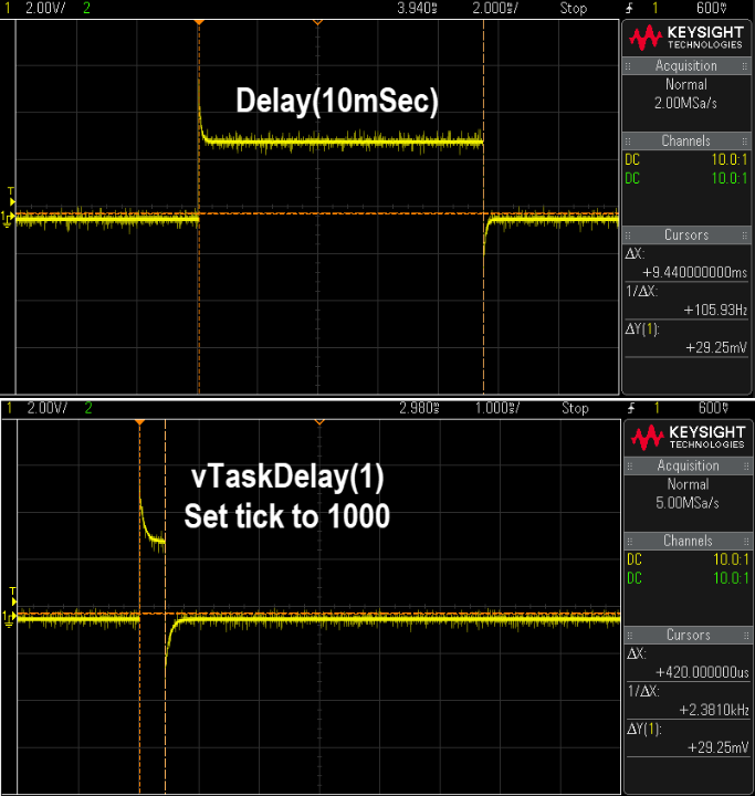

A Delay less than 10mSec does not reset the WDT!
I testet the commands for reset WDT that work.
This Both command .
1. Delay 10mSec is clear, it makes a 10mSec break(where can cause problems)

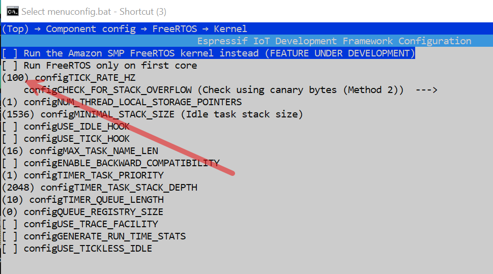

2. vTaskDelay(1); it makes a 6.5mSec break(where can cause problems) in C-Code
vTaskDelay(1);
But if I change Config TICK rate HZ from 100 to 1000, vTaskDelay(1); makes just a 0.4mSec break ,

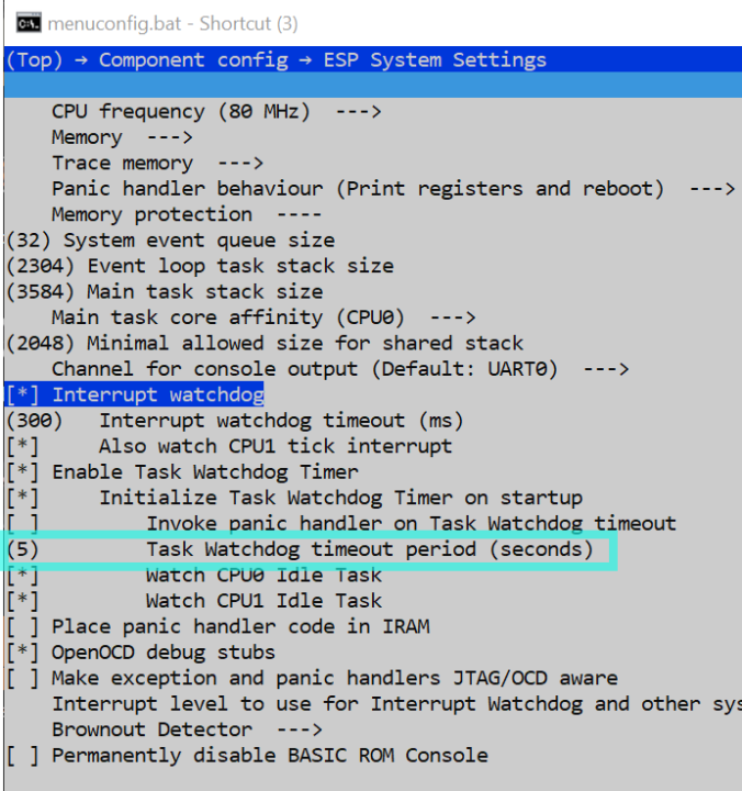

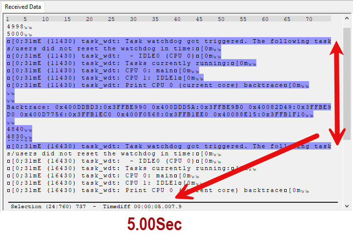

Test result: Testsoftware: I tested the Config standard setting 5 Sec for wtd timeout:
And if I not reset a have a timeout after 5Sec
This Both command .
vTaskDelay(1);

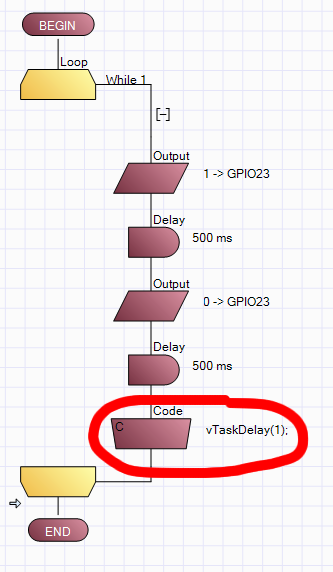

I've read all the suggestions provided so far, and they are very valuable. However, through Gemini, I came across the following trick that allows me to use delays without triggering my WDT (Watchdog Timer), even when using delays of 500ms or longer.
It might not be the universal solution for every complex case, but during my initial tests with an ESP32-C6, I was getting quite frustrated because the WDT kept interfering and rebooting the chip. I decided to start fresh with a simple program and followed Gemini's suggestion. I’m happy to report that I now have a proud ESP32-C6 blinking an LED right next to me!
The suggestion and explanation from Gemini:
"If an ESP32 reboots because its WDT is triggered, you can solve this by adding a (via a C-code block) into your main loop. This gives the underlying FreeRTOS operating system the time to execute its maintenance routines and the 'IDLE task', which automatically resets the Watchdog Timer. Without this 'breathing room', a tight loop or a blocking delay can starve the processor of the time it needs for background tasks, leading the Watchdog to assume the system has crashed and force a reboot."[/i]
Hopefully, this helps anyone else struggling with unexpected reboots on the ESP32 platform!
vTaskDelay(1);Hopefully, this helps anyone else struggling with unexpected reboots on the ESP32 platform!

Something odd going on if you are getting wdt issues - as you have flowcode delays in your code of 500 ms - using a delay block allows RTOS to context switch..
It is possible to reset the wdt - there is some code on the forum depending on which version of the espressif tools (feedthedog) or esp_task_wdt_reset() BUT it is not recommended - RTOS has multitasking and it expects tasks to yield to allow this. So ideally re-factor your code to allow this - there are alternatives to delays (waiting for notifications for example)
