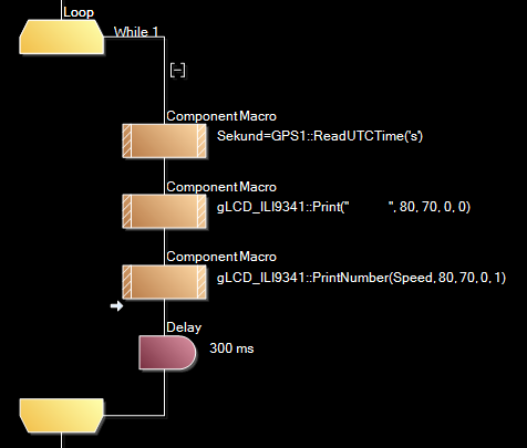

Can you check your program if you read sekund and display speed?
And which pin did you use from the ESP32?

Hi Stefan!
Thank´s for reply. Yes you have rigth concerning the Speed and second. I have change it so the return now is Second ;)
But it still not work. I have tested all the Uart input.
Channel 1 = RX0 pin A3
Channel 2 = RX1 pin A16
Channel 3 = ?
I try to swap input, use other pin, yes almost everything no luck. As I mentoied, if I test on Arduino I see the second´s. I also test with a Scope and I see data out of the GPS.

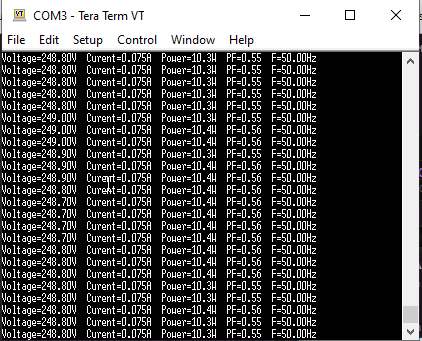

I'm currently using an ESP32 Lolin to receive data from a PZEM-004T via Modbus and I have the ESP32 sending the data via UART to Tera term:
I'm assuming as the Modbus is working then I/P and O/P of UART is working.
Plus I have an additional UART output working.
So rather than FC UART component, could be a FC GPS component issue?
