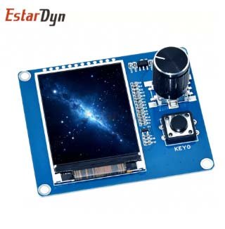

Question about the module:
Estardyn 2.0 Inch TFT LCD Display with Rotary Encoder EC11.
Cannot find some documentation about this module on net.
AI says that module should use the ST7789_driver.
Not sure if I have to use (for Nano) the level shifter (5v to 3.3v).
GND: Ground connection.
VDD: Power supply input (typically 3.3V or 5V, depending on the specific display controller and voltage regulator on board. Consult module documentation or test with 3.3V first).
SCL: I2C Clock line for the display.
SDA: I2C Data line for the display.
RES: Reset pin for the TFT display. Connect to a digital output pin on your microcontroller.
DC: Data/Command pin for the TFT display. Connect to a digital output pin on your microcontroller.
BLK: Backlight control pin. Connect to a digital output pin for backlight on/off control, or to a PWM pin for brightness adjustment.
TRA: Rotary Encoder Channel A output. Connect to a digital input pin on your microcontroller.
TRB: Rotary Encoder Channel B output. Connect to a digital input pin on your microcontroller.
PSH: Push Button output for the rotary encoder. Connect to a digital input pin on your microcontroller.
KO: Encoder Common or additional output pin. This pin's function can vary; it may be a common ground for the encoder or an additional signal. Consult specific examples for its usage.
Any help, please?

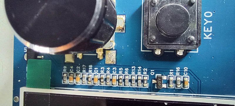

Best I can find on the module is here
https://www.aliexpress.com/item/1005012 ... cification
There are some conflicting sites but generally most suggest it is 3.3v operation (but I do see what looks to be a regulator on it so.....).
Is your Nano 5v or the newer 3.3v? Newer chips are marked Nano 33 on top of chip. If it does not state that then assume it is 5v.
Encoder appears to be connected to the module's VCC being pulled Low, so it can connect directly to any Nano as a 5v Nano will happily accept 3.3v from module.
You can check the above with a multimeter. Do note that similar encoders from cheap sources have an incredible amount of bounce and frequently are open circuit..... Cheap for a reason.
If using a 5v Nano you will need to level shift any control signals from Nano to module.
