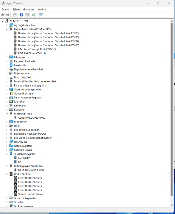

In Device Manager, under Microchip Tools, I see it listed as "Curiosity Data Gateway". It also appears as "USB Serial Device 11" in Device Manager.

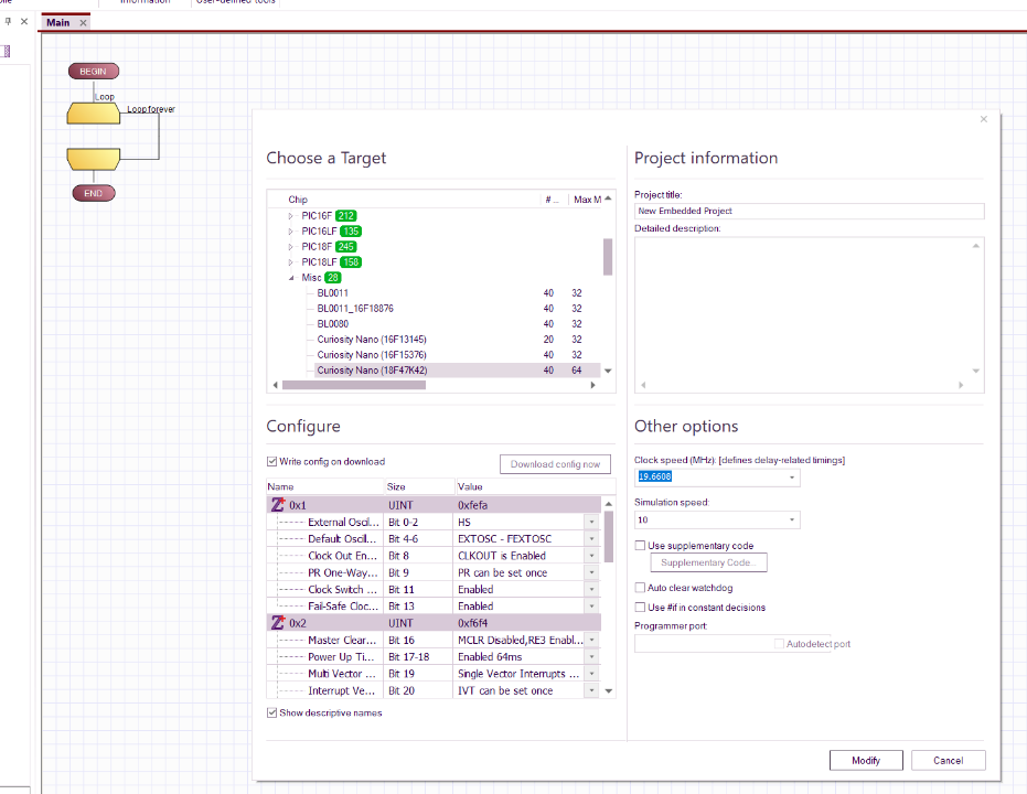

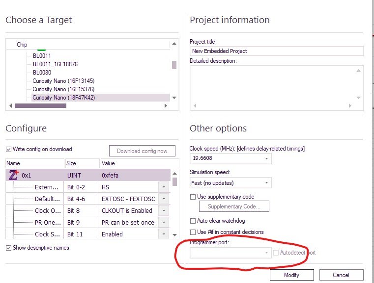

I'm using Flowcode v11 Pro. I upgraded to version v11 specifically for debugging and troubleshooting. Shouldn't Flowcode v11 automatically recognize the Curiosity Nano board? I think it should be like the Arduino Uno. When I plug it into the USB port, it should be recognized so I can install programs and use the debugging features.

The board is supported in Flowcode v11. Does Flowcode offer a programming port option to select for it (Build > Project Options) ?
If not then your PC isn't recognising it. Any yellow exclamation marks under Device Manager or the like?
