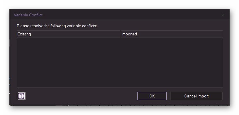

Importing a macro into an empty program:

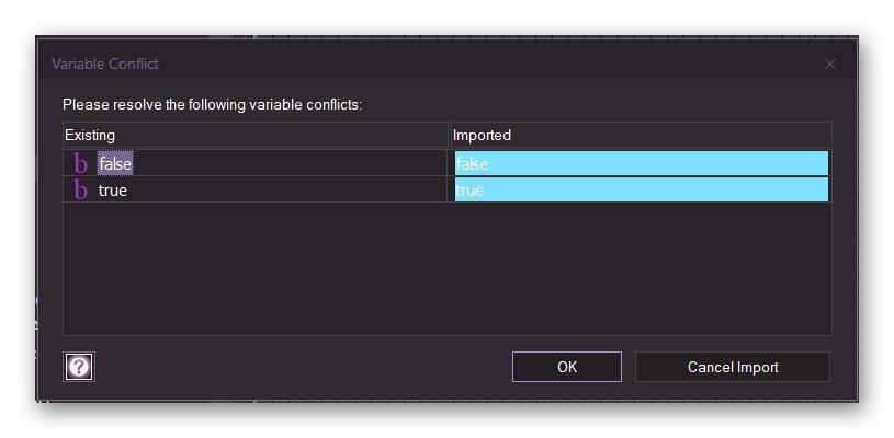

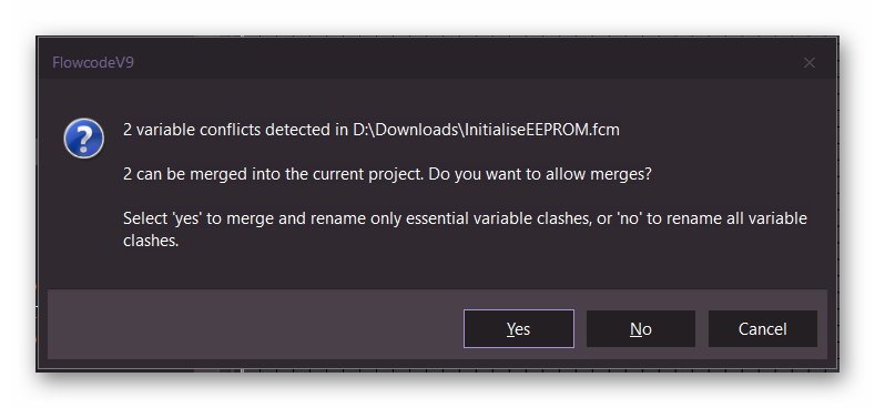

Clicking yes or no:

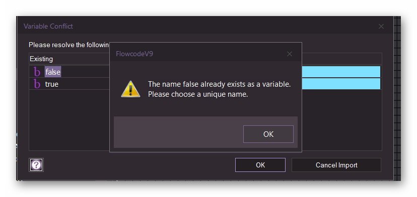

The 'clash' is on 'true' and 'false' which are global variables
The route to go is Yes and OK (on the empty list) - but still a little confusing...

Thanks, Martin.
I'll change it so the "please resolve variable clashes" is only shown if there is a non-empty list (e.g. when clicking 'yes' and all clashes are merged appropriately).
