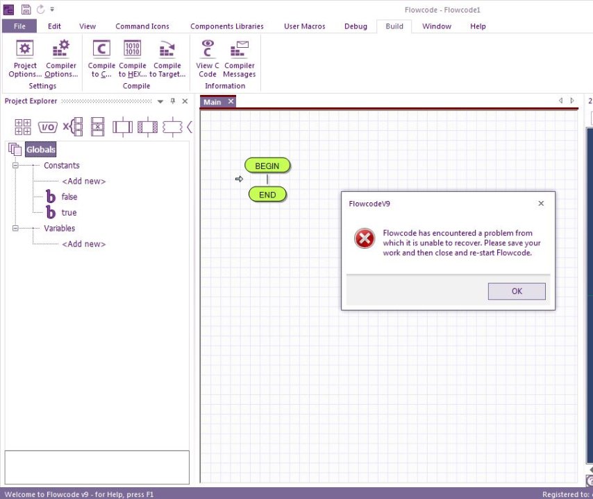

On this machine I'm running W7 and I updated from within Flowcode. Upon restart everything looked OK but when I clicked on "Build" the program froze with a warning of an unrecoverable problem. I had to use Task Manager to close.
Thinking it might be a simple screw up someplace I uninstalled FC9, rebooted, ran a registry cleaner, rebooted and downloaded FC from the website. Unfortunately when I again click on Build I crash with the same warning (attached)
Any ideas? I'm guessing I'll need to uninstall and mess with registry more than a cleaner can (I'm OK with that as long as I know what I am supposed to mess about with :) )

I'm not sure what this problem could be. Is it just the "build" button that causes this?
There could maybe be a registry corruption of the Flowcode data. You could try deleting the registry info contained here:
HKEY_CURRENT_USER\Software\MatrixTSL\FlowcodeV9
You will need to re-enter your username and password to re-activate your licence when you restart Flowcode.
Please let me know how you get on...

Hi Steve
I can click on Component Libraries etc without issue. Just seems to be with Build.
I'll try as you suggest and revert.
Thanks.

Hi Steve
Deleted the registry info.
Uninstalled
Ran registry cleaner
rebooted
ran registry cleaner (no issues)
Checked registry (no entries)
Reinstalled from download
Reentered user info
FC9 started
Still the same problem. I can click on File / Edit / View / Command etc but when I click on build, kaboom!

Unfortunately, I don't have a Win7 PC available to test and I can't replicate the issue. But I have some more questions to ask...
  1. Does the same happen when you select "new project" and when you open an existing project?
  2. Is it the same when creating a new embedded project and a new App Developer project?
  3. What about when creating new projects of different target devices - do they all have the same issue, or does it happen with only certain targets?

Hi Steve
The last attempt above I created a new embedded project using one of the free chips (877a I think). The very first attempt was when I opened an existing project (16lf1939). No indication anything was wrong in any of the above until I clicked on build.
I haven't tried app developer or trying any other "new" chip, but being honest I think the issue will still be there.
Perhaps later I'll do a system restore and see if I can recover to a previous time.
