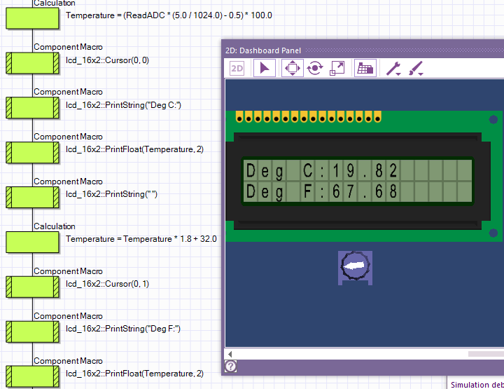

I have added a new function to both Generic LCD and I2C LCD components.
The PrintFloat function allows you to enter float variables directly without the need of using Strings and FloatToString functions.
There is an option to state the number of decimal places as well:
Displaying Temperature.png (71.18 KiB) Viewed 3911 times

Since saving the image, I have restricted the decimal places between 1 and 6.
