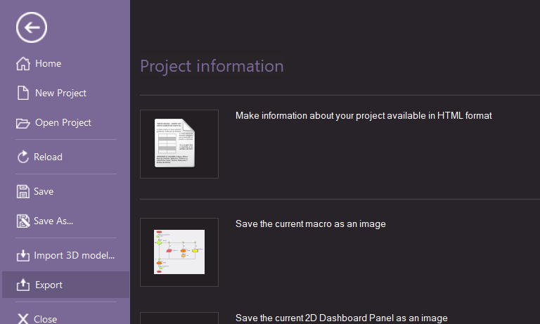

how i can print my diagram flow in flc9 ??

Hi, solozerouno.
Select the Flowchart you want to print.
Go to File, select Export.
Select Save the macro as an image.
The image is then saved for yo to print it.

Hi solozerouno, Hi Martin
There is a very nice tool in Flowcode to generate a HTML Code from your project.
Make information about your project.
Try once and open the generated HTML file.
HTML File you can open with the InternetExplorer
or if you open it with word you can edit it and you can save it as pdf.
one more advantage: In the generated folder are all picture from the macros
