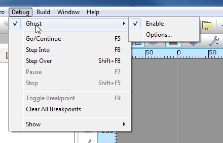

The Ghost features must be enabled by pressing the Ghost button or using the "Debug -> Ghost -> Enable" menu setting

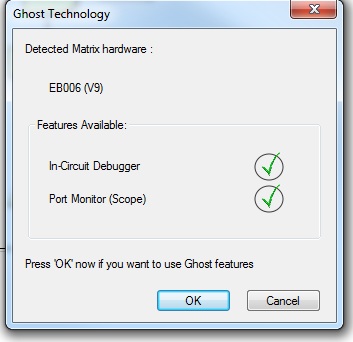

When the Ghost button is pressed, any Matrix hardware connected to the PC via USB will be detected, and the Ghost capabilities are reported, like this :-

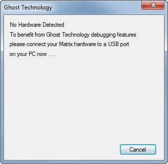

If nothing is detected, then the following message is given,
at which point some suitable hardware can be connected to the PC.
Once you have some Ghost features available, press OK to use the in circuit debugger and port monitor (ICT). For any new hardware or flowchart changes you must re-compile to chip before using the debugger (but with Ghost still enabled).

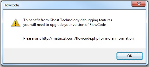

If you see the following :
it means your current FlowCode licence does not support Ghost features, so you will need to upgrade.

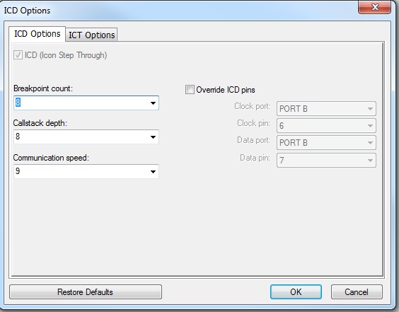

Once enabled you can configure the Ghost Options by clicking the "Debug -> Ghost -> Options" menu, this will open a new window containing the ICD and ICT options.
ICD (Icon Step Through)
Controls if the ICD functionality is active or not. When active, clicking play on the simulation will cause Flowcode to communicate with the ICD hardware and allow the execution of the simulation to sync up with the execution of the target Microcontroller.
One indication that you are indeed simulating through hardware rather than purely on-screen, is the colour of the position marker being green instead of red -
Breakpoint Count
Specifies the maximum number of breakpoints that can be set in the program.
Callstack Depth
Specifies the maximum number of jumps away from main the target Microcontroller can cope with.
Communication Speed
Specifies the bit delay when talking to the ICD target Microcontroller device. A larger number relates to slower communications speeds so if your having problems getting ICD running try increasing this value.
Override ICD pins
By default the ICD pins are wired to the programming pins to allow boards like the EB006 to work correctly. However if your using the Matrix Flowkit hardware then you can in theory use any I/O pin for the ICD communications. Regardless of which pins you are using you must take care not to read or write to the port pins used for ICD to be sure your not corrupting the communications. If you are reading or writing to the same port then be sure to use the masking feature of the input and output icons to leave the ICD pins untouched by the operation.
