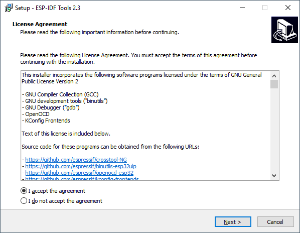

Select – I accept the agreement and click Next

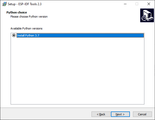

If you have Python already installed then you can select your version of Python.
Otherwise, select Install Python 3.7
Please note some versions of Python may cause the installer to fail, if this happens then try again and use the supplied version 3.7

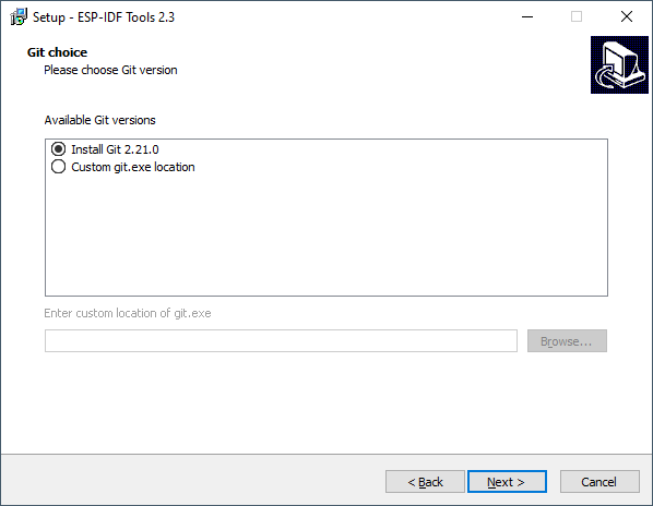

If you have Git already installed then you can select your version of Git.
Otherwise select Install Git

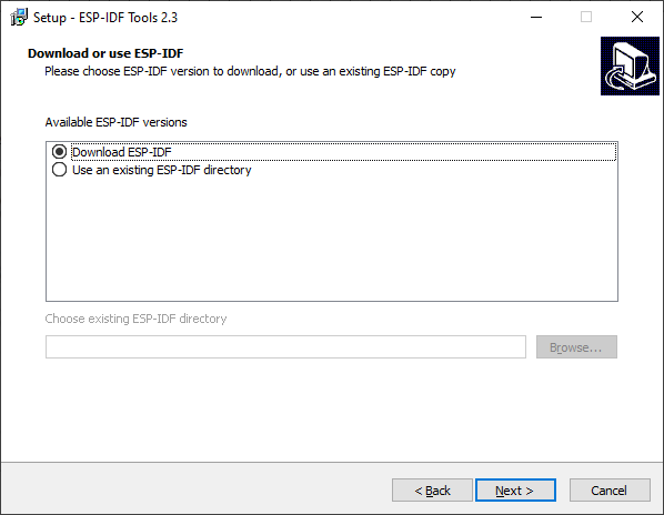

If you have an ESP-IDF already downloaded then you can select your version of ESP-IDF.
Otherwise, select Download ESP-IDF

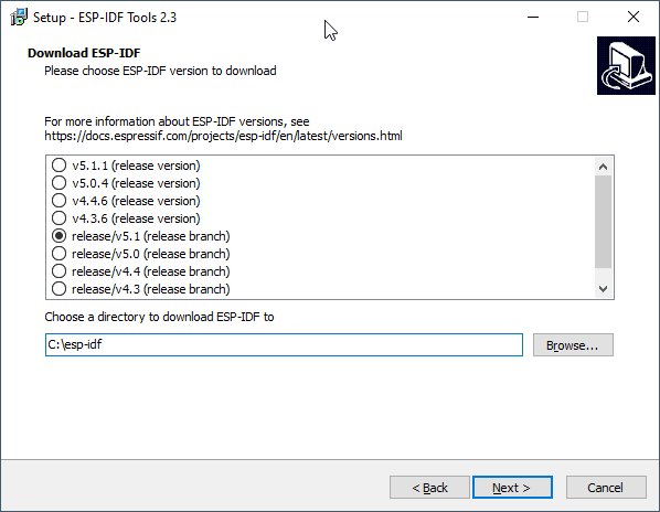

Select which ESP-IDF to install, we recommend the lowest version as the higher versions have not been tested.
At the time of writing 4.2 (Release branch is OK to use)
Install to a location on your system with no spaces in the path.
For example C:\esp-idf

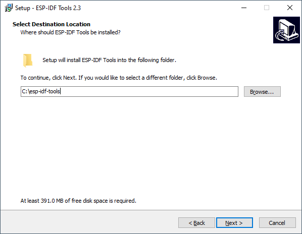

Select a location for the ESP-IDF Tools to be installed, again use a path that contains no spaces
For example C:\esp-idf-tools

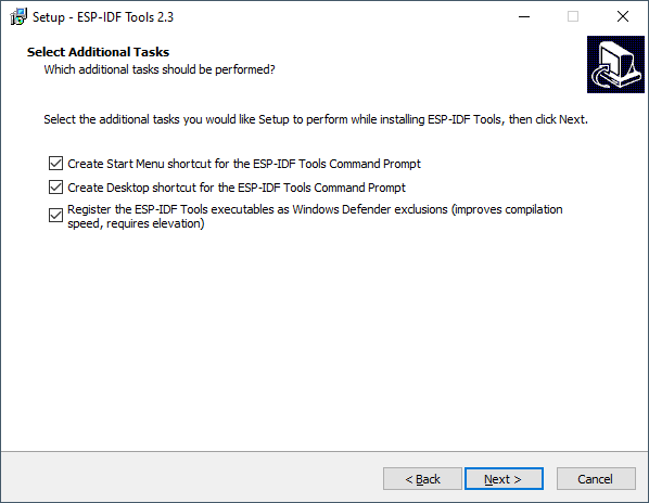

Select addition tasks, recommend keeping all options checked and click Next.
A PC reboot may be required after installation has been completed.

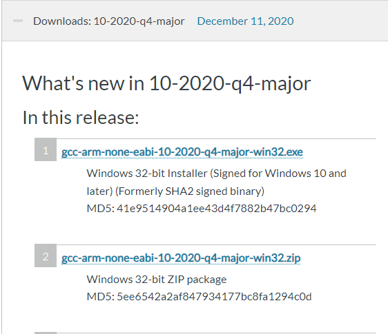

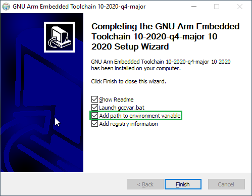

Installing ARM GCC Compiler Download the Windows Installer from: https://developer.arm.com/downloads/-/gnu-rm
During installation, you should tick the box to register the path to the ARM compiler as an
environment variable in the Windows shell:
The command prompt that the installation opened can be closed.

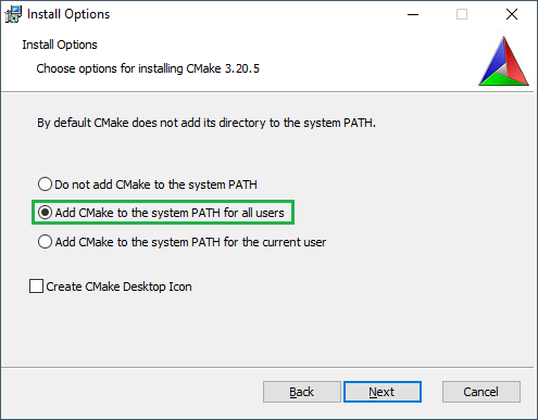

Download the Windows CMake3.20.5 Installer from: https://cmake.org/files/v3.20/
During the installation add CMake to the system PATH for all users:

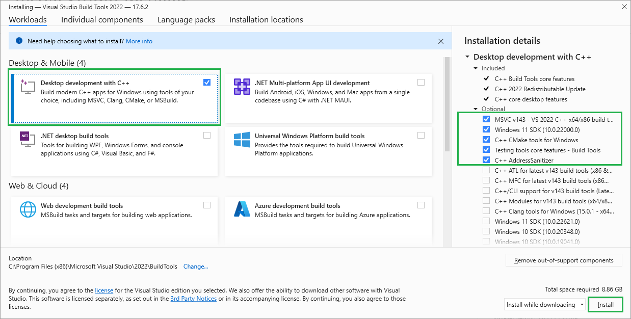

Installing Build Tools for Visual Studio 2022
https://aka.ms/vs/17/release/vs_BuildTools.exe
When prompted by the Build Tools for Visual Studio installer you need to install the C++ build
tools only.
You must install the full "Windows 10 SDK" package and leave the path as the default value:
At around 21% completed its takes a little while to continue.
This is normal

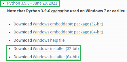

Download Windows Installer from: https://www.python.org/downloads/windows/
Look for version 3.9.6:

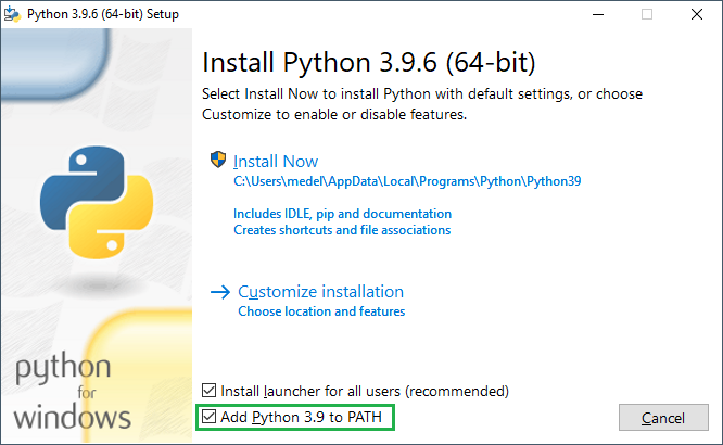

Ensure that it’s installed 'for all users' and add Python 3.9 to the system PATH:

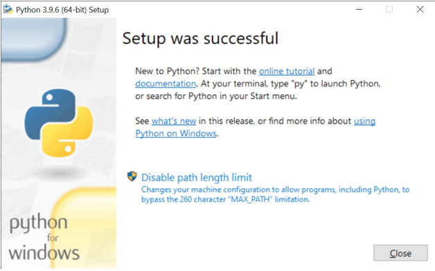

Disable the MAX_PATH length limit when prompted at the end of the Python installation:

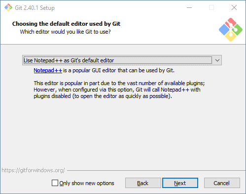

Ensure that you change the default editor away from vim, for example if you have notepad++:

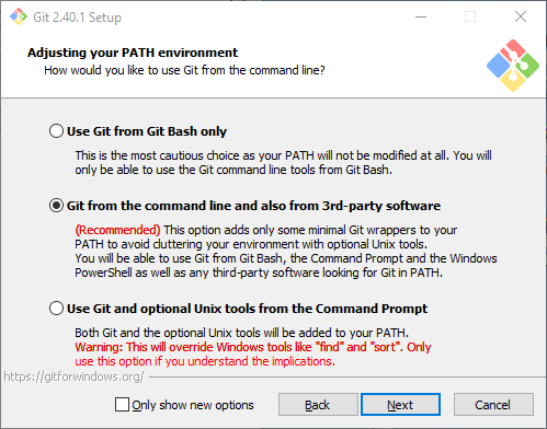

Ensure you tick the checkbox to allow Git to be used from third-party tools:
