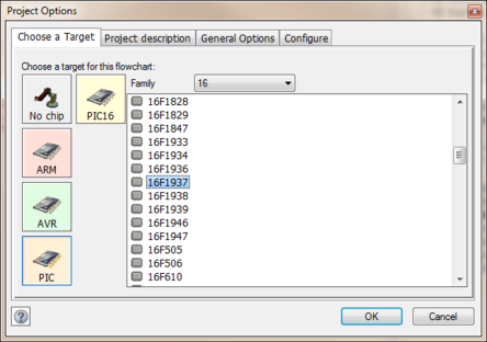

Choose a Target
Choose a target for this flowchart
This tab allows you to select a target chip from all the currently supported devices by Flowcode. Users can select a new chip or change the chip from this menu.
Devices are shown via chip types and then by device types to allow you to easily find what device and chip you wish to target.
You can also choose 'No chip' to create a simulation-only chip which will allow you to use a massive range of ports to connect to although you cannot download your flowchart program to a device, you can expand your options for simulation-only projects.

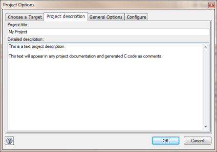

Project Description
Project title
Here users can give their project a title, this title will appear in the generated C code and in any of the documentation features of Flowcode.
Project description
Allows users to give a detailed description of the project. This information will appear in the generated C code and in any of the documentation features of Flowcode.

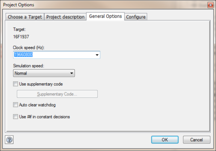

General Options
Target
Defines the microcontroller that the Flowcode compiled program will be run on.
Configuring the Chip
Allows the user to configure the target chip.
Clock Speed
Must be set to match the hardware clock frequency so that delays and other timing critical features run at the correct speed on the hardware. Several options exist for the clock speed in the drop down menu however any value of clock speed can be entered directly into the text field.
Simulation Speed
Defines the speed of the flowchart simulation. Slowing down the simulation allows for flowchart icons to become highlighted as the simulation runs.
Use Supplementary Code
Allows any supplementary code to be included into the program. This is useful for including external C or Assembler files into your programs.
Auto Clear Watchdog
This is used to automatically clear the watchdog timer every time a component macro is called which will stop the target device from detecting a false stop condition and resetting.
Use #if in Constant Decisions
Uses the preprocessor to optimise the code in if / else blocks if a constant is used in the condition statement.
