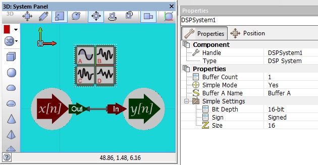

For example if we have an input component connected directly to an output component then we need only one buffer.

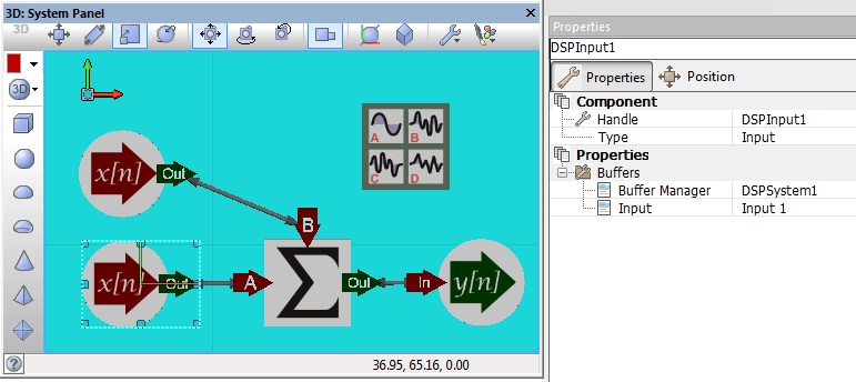

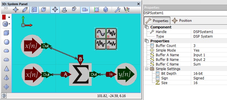

If we have two input components connected via a sum component and then onto an output component, we need three buffers. Naming the buffers can help when it comes to connecting everything up.

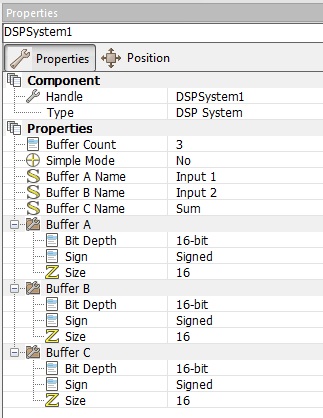

By default all the buffers have the same bit depth and sign but by disabling the simple mode property these can be manually edited for each individual buffer.
Components are connected up to the buffers by specifying the buffer manager and then selecting the buffer. The arrows automatically connect themselves up as you set the connection properties and move the component around on the panel.

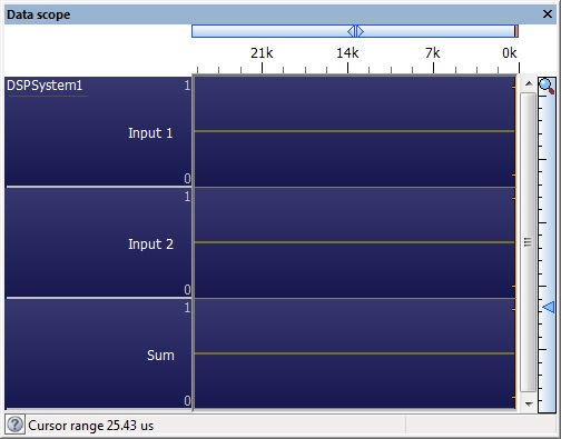

The DSP system initialise function must be called in your program before any other DSP component macros are called as it sets up the buffers ready to be used. The initialise function also sets up the scope window so if you like you can see the DSP signals during simulation to help debug or visualise what's going on.
