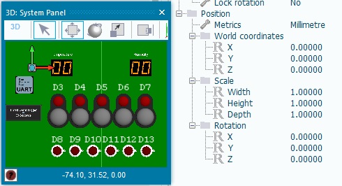

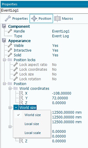

Moving to 8.2
Component GUI's have been upgraded in v8.2 to ensure all components have a meaningful item on the panel to help identify the component and where possible provide a means of simulating the component. Some of this clean up means that components added prior to 8.2 will be being incorrectly resized when loading your project. We have taken every measure possible to avoid this but with some components it has been unavoidable.
An easy way to get the component looking the way it should be it to use the Properties Window and the Position Tab. Click on World Size and select Local Scale from the menu.
Now select the component on the panel and set the local scale to 1, 1, 1 for the X, Y and Z (Just X and Y on the 2D panel).
