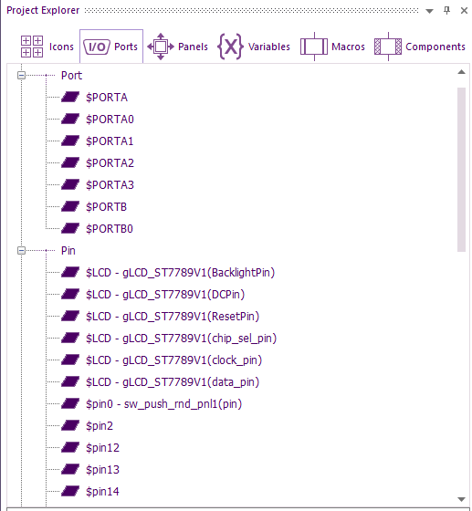

Ports
The Project Explorer shows the available ports for the currently selected device.
You can directly reference these ports in calculations or other expressions and connect components to these ports, by right-clicking the port or clicking on the arrow next to the port name you can select 'List occurrences' which will use the Icon lists pane to show where the ports are being used and referenced.
You will also be able to see all the pins that have components connected to them.

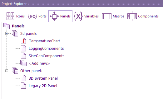

Panels
Since you can have multiple 2d panels open, this tab will show all the panels that have been added.
There is an option to add more panels if required.
Each panel can be right-clicked on to rename, change the colour, gridlines, etc by selecting properties.
The red exclamation mark is warning you the panel has been closed.
To open the panel, either right-click on the panel name and select show, or double-click on the panel name.

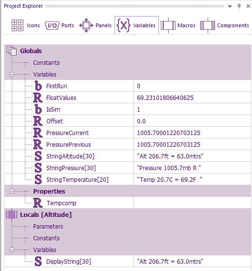

Variables
This section shows all the global constants and variables used in the project.
Globals are visible to any macro in the project.
You can add, edit and delete both global constants and variables from this section.
You can also use the 'List occurrences' option previously mentioned to list where these variables are being used.
If the speed of the simulation is changed to Fast (with updates) via the Simulation debugger, (for this you will need to have the simulation paused) or via Project_Options Then when the simulation is running all the global and local variables (only if within the appropriate call macro) values will be shown.
If the simulator is paused then the variable's values can be changed by left-clicking the variable's current values.
As well as global variables, local variables present within the Macro which you currently have selected, if you change the currently selected macro by clicking on another Macro tab in the main flowchart window, this Project Manager tab will update to show you the new local variables associated with the newly selected Macro.
