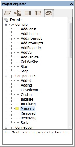

The Project Explorer events tab is used to list all the available events and provides a quick way of seeing which events are active in your Flowcode project.
The events tab is hidden by default but can be included by using the Global Options - UI Trees tab.
When an event is active a small macro icon will appear next to the event.
By hovering over the events you can see a short description of when the event will be called and what parameters will be passed to it.
By double clicking the event you can edit the macro assigned to it. Double clicking the macro item will automatically add an event macro for you with a name specific to the event name. Selecting disabled will deactivate the event and prevent it from firing.
