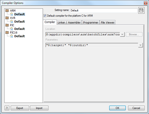

Compiler
Compiler location
Sets the location of the file controlling compilation
Default:
$(compilerstarm)batch\stm32comp.bat
Compiler parameters
Adds command line parameters when called from Flowcode
Default:
""$(target)" "$(outdir)" "$(chipalt)" "$(family)" "$(lscript)" "$(clock)" "$(romsize)" "$(ramsize)"

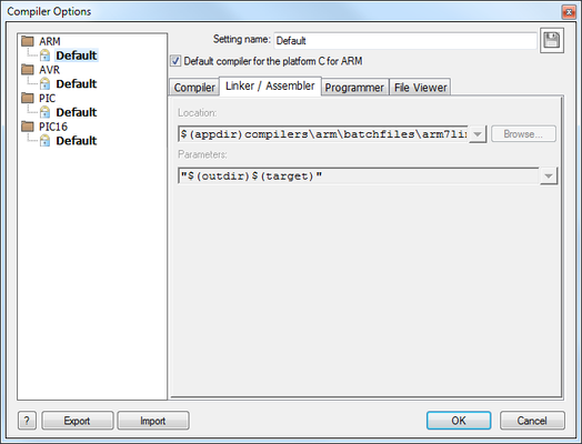

Linker/Assembler
Linker/Assembler location
Sets the location of the file controlling linking and assembly
Default:
$(appdir)tools\DoNothing\DoNothing.exe
Linker/Assembler parameters
Default:
<empty>
There are no default parameters

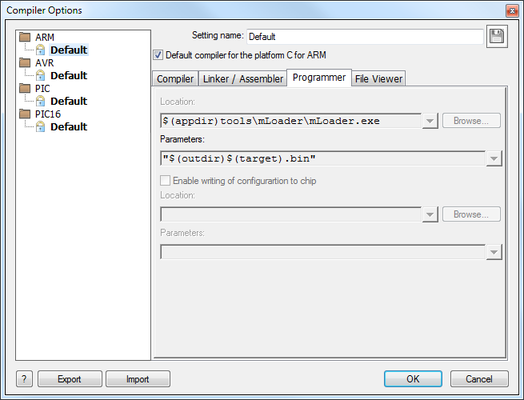

Programmer
Programmer location
Sets the location of the file controlling the programming of the target device
Default:
$(compilerstarm)batch\stm32prog.bat
Programmer parameters
Default:
""$(outdir)" "$(target)"
Use programmer to set configuration options
This box should be left unchecked
Configuration parameters
This box should be left empty. Configuration parameters are set and downloaded from the Build > Configure menu.
