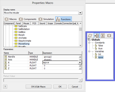

- the second Simulation macro:
- name it "Move the intruder";
- click on the 'Panel' tab, and then on the 'Position' folder;
- click on the 'MoveAlong' macro and:
- choose 'group2'(the intruder)as the Handle;
- choose 'shape1'( the brick wall) as the Axis;
- click on the down arrow on the end of the 'X' row, and create a floating point variable called "xpos", with an initial value 5.0, to use as the X variable;
- click on OK.
