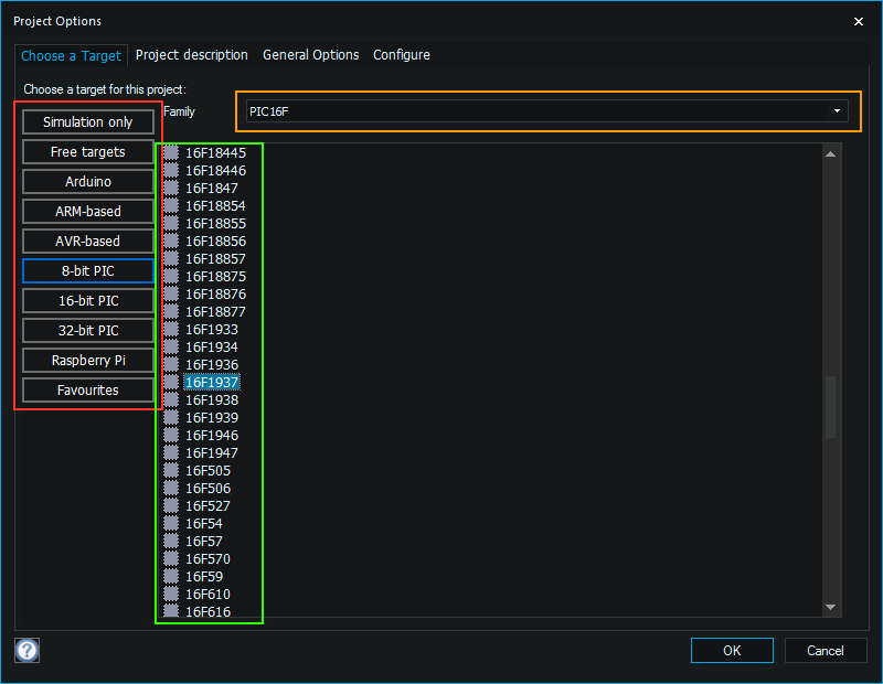

Selecting device type from within Flowcode
You can change devices at any time by selecting Build > Project Options. Simply select the chip type from the left hand menu (red rectangle), then use the drop down menu (orange rectangle) above to change the chip family to narrow down the chip list. Finally scroll down the chip list (green rectangle) to find your desired device.
Use this option to specify which microcontroller you wish your flowchart to target. If you are changing from one microcontroller to another, Flowcode will check that all the commands and components in your flowchart are supported by the new microcontroller. Flowcode will advise you of any potential problems.
