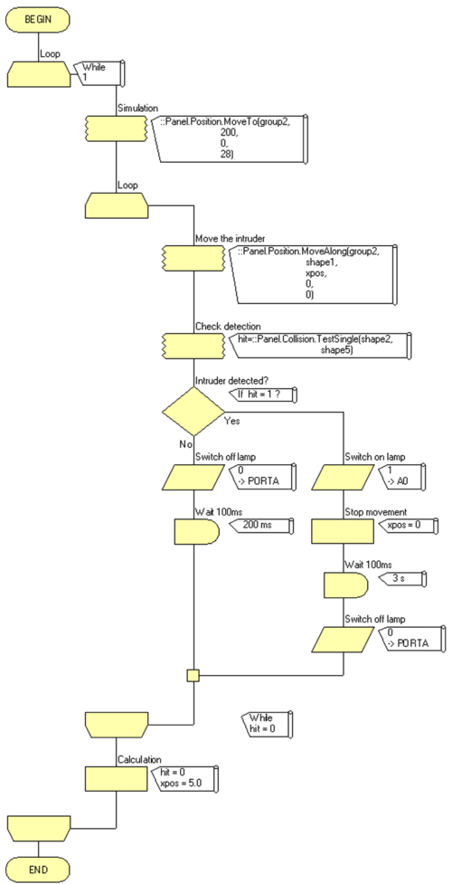

The plan:
- Set the initial position of the intruder, using the 'MoveTo' simulation macro.
- Move the intruder towards the detection cone using the 'MoveAlong' simulation macro.
- This changes the x coordinate of the intruder by an amount specified by the variable 'xpos'.
- When the intruder enters the detection zone, the simulation macro 'CollisionTest' returns a value of '1' in the variable 'hit'.
- At this point, we stop any more movement so that we can look at the x coordinate of the intruder.
- To do so, we change the value of 'xpos' to zero.

- On the Startup screen, click on 'New project' to create a new flowchart.
- Add the icons shown in the flowchart:
- a loop icon, configured as an infinite loop, and within it:
- Within the second loop, add:
- two more Simulation macro icons;
- a decision icon with:
- a 'Yes' loop containing an output icon, followed by a delay icon and then a calculation icon;
- a 'No' loop containing an output icon, followed by a delay icon;
- Configure the icons, by double clicking on each in turn, as follows:
- the top Simulation macro:
- name it "Set initial position";
- click on the 'Panel' tab, and then on the 'Position' folder;
- click on the 'MoveTo' macro and:
- choose 'group2'(the intruder)as the Handle;
- set the X value to "200";
- set the Y value to "0";
- set the Z value to "28";
- click on OK.
- the second loop:
- set it to 'Loop while:' "hit = 0";
- 'Test the loop at the:' 'End'
- Click on OK.

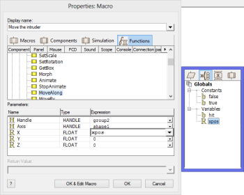

- the second Simulation macro:
- name it "Move the intruder";
- click on the 'MoveAlong' macro and:
- choose 'shape1'( the brick wall) as the Axis;
- click on the down arrow on the end of the 'X' row, and create a floating point variable called "xpos", with an initial value 5.0, to use as the X variable;
- click on OK.
- the third Simulation macro:
- name it "Check detection";
- click on the 'Panel' tab, and then on the 'Collision' folder;
- click on the 'TestSingle' macro and:
- choose 'shape2'(the detection cone) for 'Pos' and 'shape5' (the intruder's head,) for 'Test';
- use the down arrow at the end of the 'Return Value' box to create a boolean variable caled "hit" to use as the 'Return Value'.
- click on OK.
- the decision icon:
- name it "Intruder detected?";
- insert the condition "hit = 1";
- click on OK.
- In the 'Yes' loop:
- name the Output icon "Switch on lamp";
- send value '1' to Port A single bit 0;
- click on OK.
- name the Delay icon "Wait 100ms";
- configure it to give a delay of 100ms;
- click on OK.
- name the Calculation icon "Stop movement";
- in the 'Calculations:' box, insert "xpos = 0" to reduce the distance incremented each time to zero;
- click on OK.
- In the 'No' loop:
- name the Output icon "Switch off lamp";
- send value '0' to Port A single bit 0;
- click on OK.
- click on OK.
- the final Calculation icon:
- name it "Reset variables";
- in the 'Calculations:' box, insert "hit = 0" and "xpos = 5.0";
- click on OK.
The Flowcode flowchart resembles the one shown below:
Testing
- Run the simulation.
- The intruder should move towards the house, until he enters the detection zone.
- At this point, the warning lamp turns on and he stops for three seconds.
- Then the simulation repeats.
