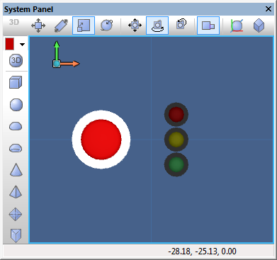

First of all, we are going to set up the System Panel and add two more LED components to expand the program.
- Add two LED components by using either of the following methods:
- Either copy and paste the current component on the System Panel to duplicate the component.
- Or add two more components by using the Components Toolbar.
Now position the LEDs accordingly on the System Panel.
- Move the LEDs to be aligned in a row on the Y axis.
- Ensure the original green LED component is at the bottom and that it is still connected to '$PORTB.0'.
Next change the colour and connection properties of the two new LEDs.
- Change the middle LED properties.
- Connect the LED to Port B Pin 1 by changing the 'Connection' property to '$PORTB.1'.
- Change the 'Color' property to yellow (00FFFF) using the colour selection window.
- Change the top LED properties
- Connect the LED to Port B Pin 2 by changing the 'Connection' property to '$PORTB.2'.
- Change the 'Color' property to red (000FF) using the colour selection window.

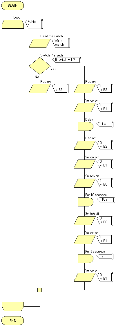

Now that the components are set up correctly, its time to configure the flowchart and expand the program. Firstly we need to set up the default state of the traffic lights to display only the red light when the switch is not pressed.
- Add an 'Input' icon to the 'No' section of the 'Decision' icon.
- Change the 'Display name:' to "Red on".
- Input the the value "1" into the 'Variable or value:' box.
- Set the 'Port:' connection to 'PORTB'.
- In the 'Output to:' section select 'Single Bit:' and change the pin to '2'.
- Click 'OK' to confirm the changes to the icon.
We are now going to set up the activation sequence of the traffic lights by configuring and expanding the 'Yes' section of the 'Decision' icon.
- Add 4 'Input' icons above the existing icons, then add a 'Delay' icon in-between the 4 'Input' icons.
- We will configure these icons top to bottom as follows:
- Change the 'Display name:' of the first 'Input' icon to "Red on".
- This icon is the same as the previous one we set up in the 'No' section of the 'Decision icon'.
- Send the value '1' to Port B, Pin 2.
- For the second 'Input' icon change the name to "Yellow on".
- Similarly send the value '1' to Port B but this time send it to bit (pin) 1
- Next is the 'Delay' icon.
- Change the name to "For 1 second".
- Input the value "1" into the 'Delay value or variable:' box.
- Change the unit to 'seconds'.
- Switch the first two (red and yellow) lights off to allow the last (green) light to show on its own which we programmed before.
- Alter the 'Input' icon after the 'Delay' icon.
- Change the 'Display name:' to "Red off".
- Send the value "0" to Port B, Pin 1 - this switches off the red light.
- Configure the next 'Input' icon, the last of the new icons we added.
- Name it "Yellow off".
- Send the value "0" to Port B, Pin 2 - this switches off the yellow light.
Next, the green light displays for 10 seconds before switching off, this is due to the icons we configured and programmed in the earlier exercises.
- Update the display names of the existing icons as follows:
- Replace the "Switch on" display name with "Green on".
- Replace the "Switch off" display name with "Green off".
- Under these icons add an 'Input' icon, followed by a 'Delay' icon and finally add the last 'Input' icon.
- Configure the first 'Input' icon.
- Change the 'Display name:' to "Yellow on".
- In the 'Variable or value:' box type "1".
- Change the 'Port:' to 'PORTB'.
- In the 'Output to:' section select 'Single Bit:' and change the value to '1'.
- Now configure the 'Delay' icon.
- Change the 'Display name:' to "For 2 seconds".
- Type "2" into the 'Delay value or variable:'.
- Finally configure the last 'Input' icon.
- Change the 'Display name:' to "Yellow off".
- In the 'Variable or value:' type "0".
- In the 'Output to:' section select 'Single Bit:' and change it to '1'.
