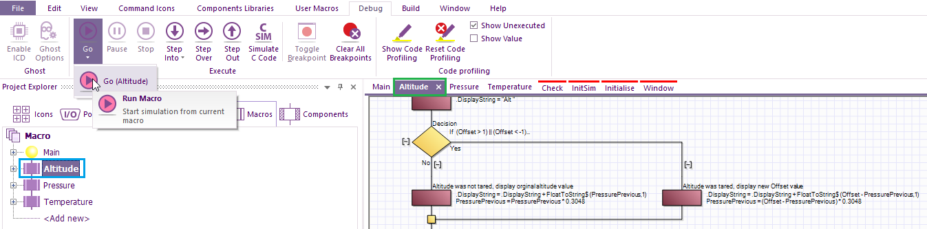

Alternatively, you can choose to start within any user-created macros by first selecting either the user macro from the project explorer (outlined in Blue) or From the user macro (outlined in green) you wish to start from. In the example below: Run from user macro.png I have chosen 'Altitude', then select the down arrow just below the word Run. You will see there is another Run icon with the words Run (Altitude). When you left-click on it, the simulation will start from the within the first icon of the 'Altitude' user macro
