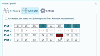

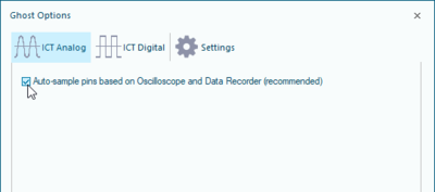

Sample masks
You can set the sample mask that Ghost uses to decide which pins should be recorded. It is recommended for most cases that you leave this set to automatic mode.
Automatic sampling mode (recommended)
However, if you wish to set the sample mask manually, you can uncheck the box and choose which pins should be sampled.
Manually selecting which pins should be sampled

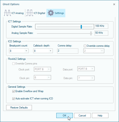

General settings
The settings tab controls various aspects of the ICD and ICT functionality.
General Ghost settings
ICT Settings: Controls the digital and analog sample rates, note that the analogue sample rate is scaled based on the digital sample rate.
ICD Settings: Controls the number of breakpoints, the maximum size of the stack and the communications time-out delay.
Flowkit 2 Settings: Only configurable when you have a FlowKit 2 board connected, these control the two target pins used for ICD communications. These pins cannot be used in your program or you risk ICD communications being unreliable or unavailable.
Enable Overflow and Wrap: This controls what happens if the ICT buffer runs out of memory.
  • Checked: If the ICT buffer runs out of memory then the contents of memory are wiped allowing ICT to continue, you may notice a glitch on your scope traces.
  • Unchecked: If the ICT buffer runs out of memory then ICT mode is automatically switched off, this guarantees that there are no glitches in the data.
Auto-activate ICT when running ICD: This automatically toggles ICT (pin sampling) when ICD is running. Note that there is no other way to make use of the data recorder otherwise, as simulation data is not available in ICD mode.
