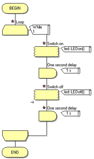

- Build the flowchart as follows:
- Open the 'Outputs' toolbox, where you stored the exported 'newLED' component.
- Locate the 'newLED' component, and use the down-arrow next to it to add it to the System Panel.
- Drag and drop a 'Loop' icon onto the flowchart. Leave it in its default state, to loop indefinitely.
- Drag and drop a 'Component macro' icon inside the loop.
- Double-click on it so that you can configure it.
- Click on the 'Simulation' tab to see the associated macros. You should see two, called 'LEDoff' and 'LEDon'.
- Click on the 'LEDon' macro. Change the 'Display name' to "Switch on" and click 'OK'.
- Drag and drop a 'Delay' icon to follow the 'Component macro'.
- Double-click on it, rename it "One second delay" and change the unit to 'seconds'.
- Drag and drop a second 'Component macro' to follow the one second delay.
- Double-click on it. Rename it "Switch off" and select the 'LEDoff' macro. Click on 'OK'.
- Drag and drop a second 'Delay' icon after the second 'Component macro' and configure it as you did the first. (Alternatively, click on the first icon, and 'copy and paste' it, and then move it to the correct position in the flowchart.)
- Your flowchart should now resemble the one shown below:
