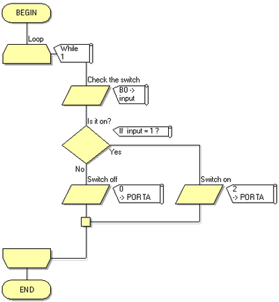

The Flowcode flowchart
- Add an infinite loop to the flowchart, and inside it:
- Drag and drop an 'Input' icon.
- Double-click on it to configure it.
- Rename it "Check the switch".
- Click the down arrow at the end of the 'Variable:' box.
- Next click on the down arrow in front of the label 'Variables', and select the 'Add new' option.
- The 'Create a New Variable' dialogue box opens. Enter the name "input" for the new variable.
- Leave the 'Initial value' and 'Description' boxes empty, and leave the variable type as 'byte'.
- Click on 'OK'.
- In the 'Variable:' box in the input properties dialogue box, type the name "input".
- Select PORT B as the 'Port:' and 'Input from:' 'Single Bit:' 0.
- Click on 'OK'.
- Drag and drop a 'Decision' icon.
- Rename it "Is it on?".
- In the 'If:' box, type "input=1" - using the variable 'input' you created earlier.
- Click on 'OK'.
- Drag and drop an 'Output' icon into the 'Yes' branch of the 'Decision' icon.
- Rename it "Switch on".
- Enter the number "2" into the 'Variable or value:' box.
- Leave the other settings as 'PORTA' and 'Entire Port:'
- Click on 'OK'.
- (When Flowcode outputs the decimal value '2' to PORT A, bit 1 of that port will be set at logic 1.
- As the LED is attached to bit 1, it will switch on.)
- Drag and drop a second 'Output' icon into the 'No' branch of the 'Decision' icon.
- Rename it "Switch off".
- Enter the number "0" into the 'Variable or value:' box.
- Select 'PORTA' and 'Entire Port'
- Click on 'OK'.
- The flowchart should resemble the one opposite. Save it as "Headlight warning".
