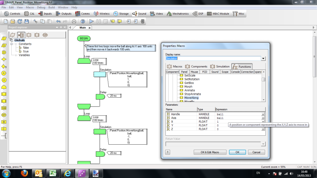

::Panel.Position.MoveAlong(handle, axis, x, y, z)
Flowcode example file
Download

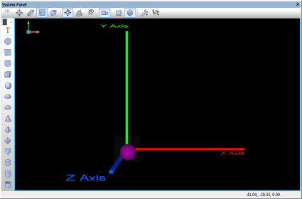

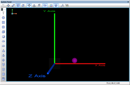

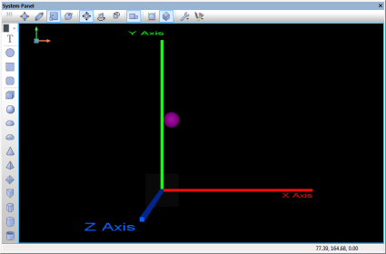

SIMAPI_Panel_Position_MoveAlong and open it in Flowcode v6. In this example, there are three cubiods that represent Axis X,Y,Z. Note they are coloured exactly as the panel axis indicator which represents your viewing position. There is a sphere also on the panel. The sphere moves first along the X-Axis 100 units then back to it's original position, then does the same for the Y and Z axis. Note - to see the sphere moving along the Z axis you will need to turn on perspective or change the viewing plane with via the panel axis indicator.
The screenshots below show the effect and also highlight the code used by the example.
